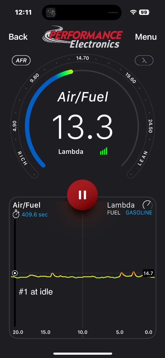

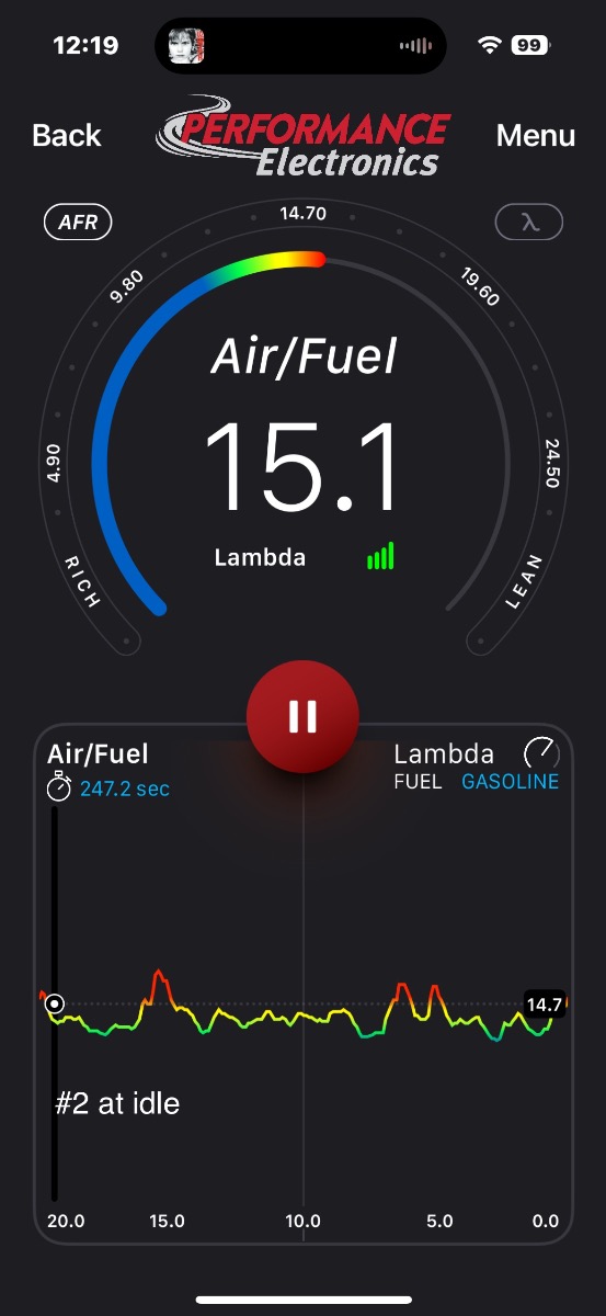

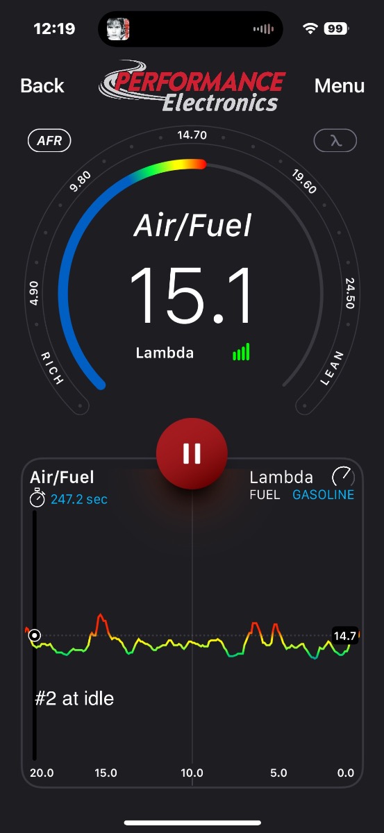

Carbs are rebuilt and clean. Coils are brand-new Dynatek, points replaced with electronic ignition. Plug wires are new. Choke plungers rebuilt. New fuel lines, new spark plugs, and a Pingel dual-outlet petcock.I am not trying to turn carbs into fuel injection.At idle, the bike audibly stumbles, and that stumble happens at the same moment the AFR spikes. I don’t know which is the cause and which is the effect.Cylinder #2 shows intermittent pockets of lean AFR. Cylinder #1 does the same thing, but to a lesser degree. These traces are all at idle (~1000 RPM). The issue largely goes away if I raise idle speed to ~1200 RPM.The bike is fully warmed up, but the issue is worse when cold. I don’t believe there are intake or exhaust leaks. Carbs have been synchronized.For reference on the graph:
• Green ≈ 12 AFR
• Red = anything above 14.7 AFRThis puzzle probably has nothing to do with jetting, and I’d prefer not to go down that rabbit hole—but for completeness, here is how it’s currently set up.Dec 20 update (after rebuilding choke plungers):

- Cylinder 1:
(Pilot 10 / Main 100 / Clip 2 / 3 mm)
Small AFR pops at the same frequency as #2, but much smaller. Otherwise AFR looks good. - Cylinder 2:
(Pilot 12.5 / Main 102.5 / Clip 3 / 3 mm)
Large AFR swings—almost like a backfire, but still within range. - Cylinder 3:

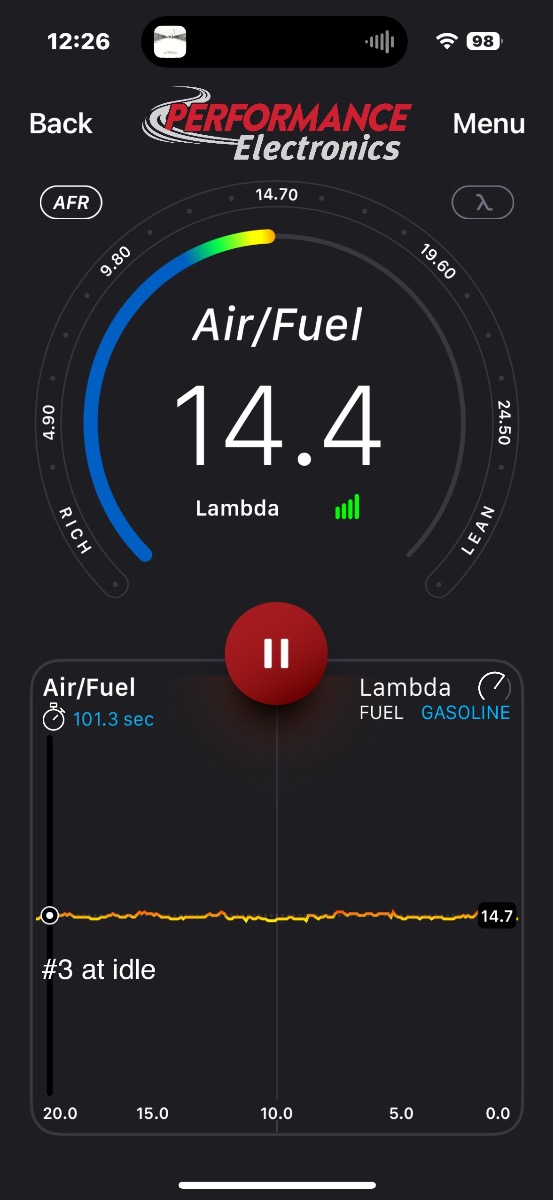

(Pilot 10 / Main 105 / Clip 4 / 3 mm)
Perfect idle. - Cylinder 4:

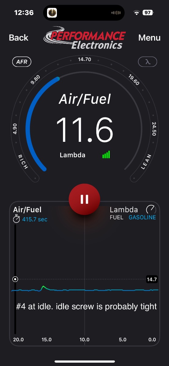

Idle is too rich; pilot screw is almost fully closed.
