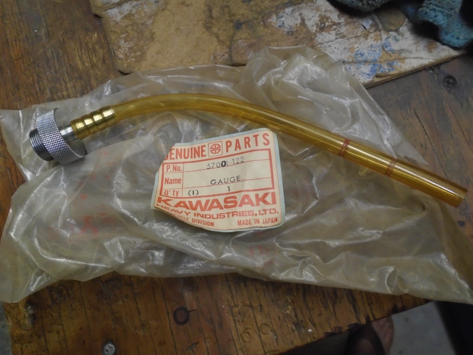

Mike there are two distinct different "types" of hanging idle. One being a leaking manifold other being an over-rich condition but burning it off slowly keeps idle too high. A vacuum leak doesn't generally go away, over-rich does. Double check your fuel level first. If choke plungers, i have a trick for that too. These ramp style carbs are finicky to start with and any glitch in the array of multiple springs/seats/levers can make things worse. Also if carbs have been "gone thru" make sure the jet holders haven't been over tightened. I warped, even slightly can grab the slide jet needle and keep it's slide from fully seating. Keep us informed.

Thanks for the help
i set float hight manually I will get the tube gauge
what is your trick with the choke ? I was going to buy new assemblies ?
