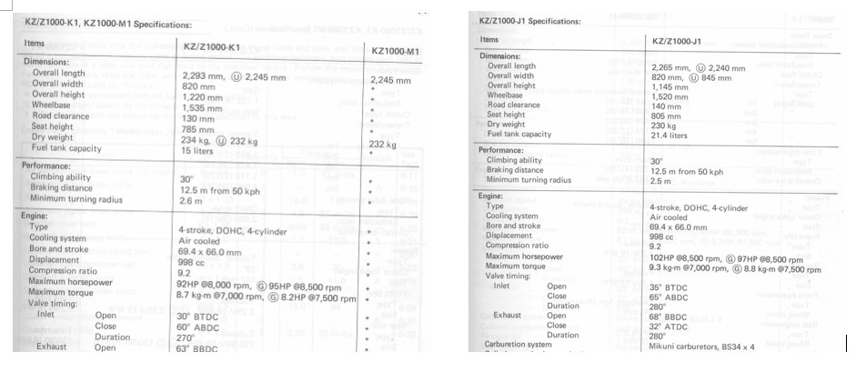

Hi I'm sorry if this topic is posted too much but I'm hung up on the jetting for the kz1000j model cams since in the manual they show the pilot air jets, needle jet, and jet needle as being different.
I just bought myself this christmas present on ebay and I can't find any information on those pilot air jets!!! They aren't even showing up in diagrams and such. My question is what's important for rejetting for these cams? Could anyone else that has done this swap chime in on what they did? I'm just looking to get more top end power out of my girl. Thanks!

I'm going to challenge you on your claim that carburetor jettting and needles shouldn't be affected too much since in the manual its telling me to go from a 122.5 to a 127.5 main jet. If I get the sizing right, that's two sizes larger so those cams should be making a difference... that's if my intuition is correct. Feel free to call me out though cause I may be overthinking this. Im more concerned about the jet needle and needle jet because I don't have at least one of those.
