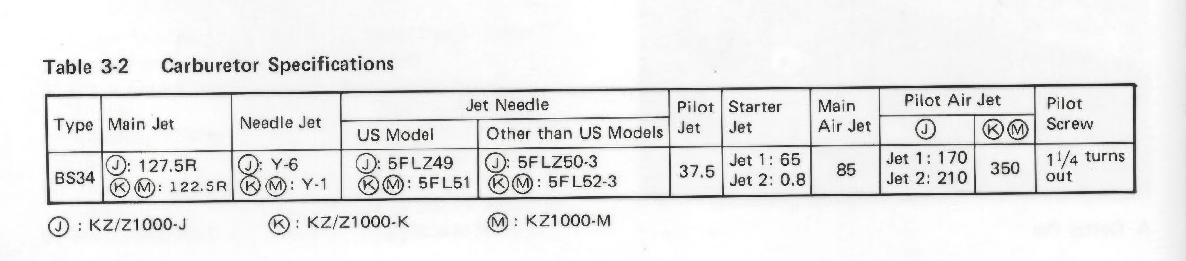

Hi I'm sorry if this topic is posted too much but I'm hung up on the jetting for the kz1000j model cams since in the manual they show the pilot air jets, needle jet, and jet needle as being different.
I just bought myself this christmas present on ebay and I can't find any information on those pilot air jets!!! They aren't even showing up in diagrams and such. My question is what's important for rejetting for these cams? Could anyone else that has done this swap chime in on what they did? I'm just looking to get more top end power out of my girl. Thanks!

I'm going to challenge you on your claim that carburetor jettting and needles shouldn't be affected too much since in the manual its telling me to go from a 122.5 to a 127.5 main jet. If I get the sizing right, that's two sizes larger so those cams should be making a difference... that's if my intuition is correct. Feel free to call me out though cause I may be overthinking this. Im more concerned about the jet needle and needle jet because I don't have at least one of those.

Thank you so much, therefore from what I understand the difference in performance of the two models is more or less similar to comparing textbook to the real world. Do you still think it would be a good idea to change to the 127.5 main jets and the 5flz50 needles? Im only asking since they came with a carb rebuild that I held onto. As always, when I get the camshaft and install it, I'll test what works best. Too bad that I don't see any of those gpz1100 camshafts around anymore. Couldn't find any on ebay. Im new to the community so I'll take your wise words. I appreciate all the help!

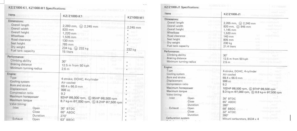

I have a "foot in both camps" here, with the exception of the German, Swiss and Sweden models the "J" makes around 10% more power slightly higher up the rev band (10% ain't bad for a soft tune) It looks like the "J" uses a different carb casting (two pilot air jets) but the biggest difference seems to be the main and needle jets (no idea how much of the 10% is cams and jetting and how much is air box and exhaust) As I understand it the "K & M" are a "soft tune" of the "J" spec

Wookie if I remember correctly, aren't you running two intake cams from the J on one of your bikes? If that's right, how is that going for you? I know it won't be the same but what's your carburetion looking like? The only jet that I dont have is the needle jet. Would having a Y-1 needle jet be too different to match with the 5flz50 that's usually paired with the Y-6 needle jet or does it matter that much as stated by zed? Carburetors confuse me sometimes...

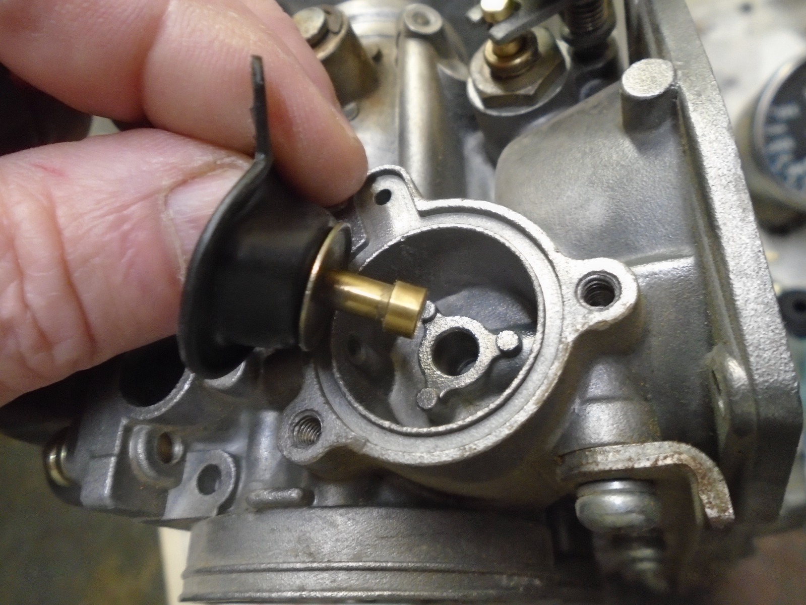

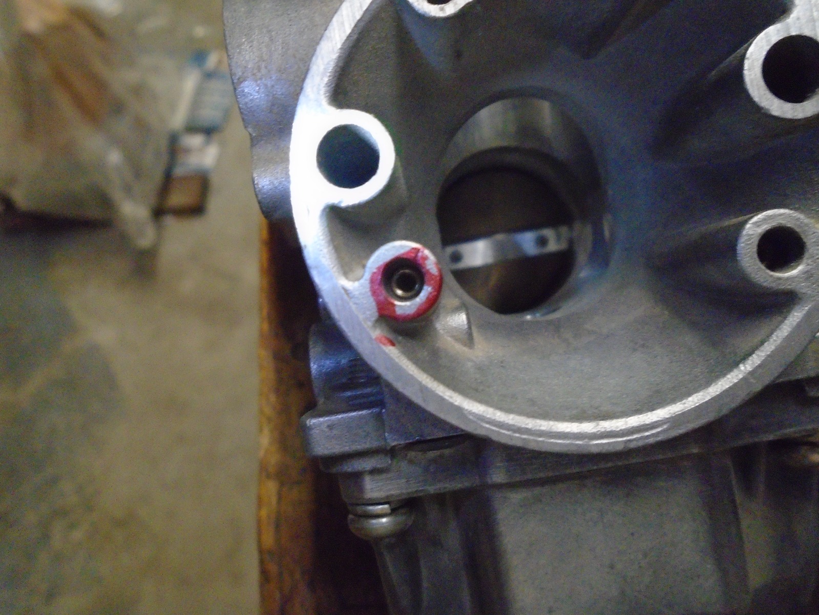

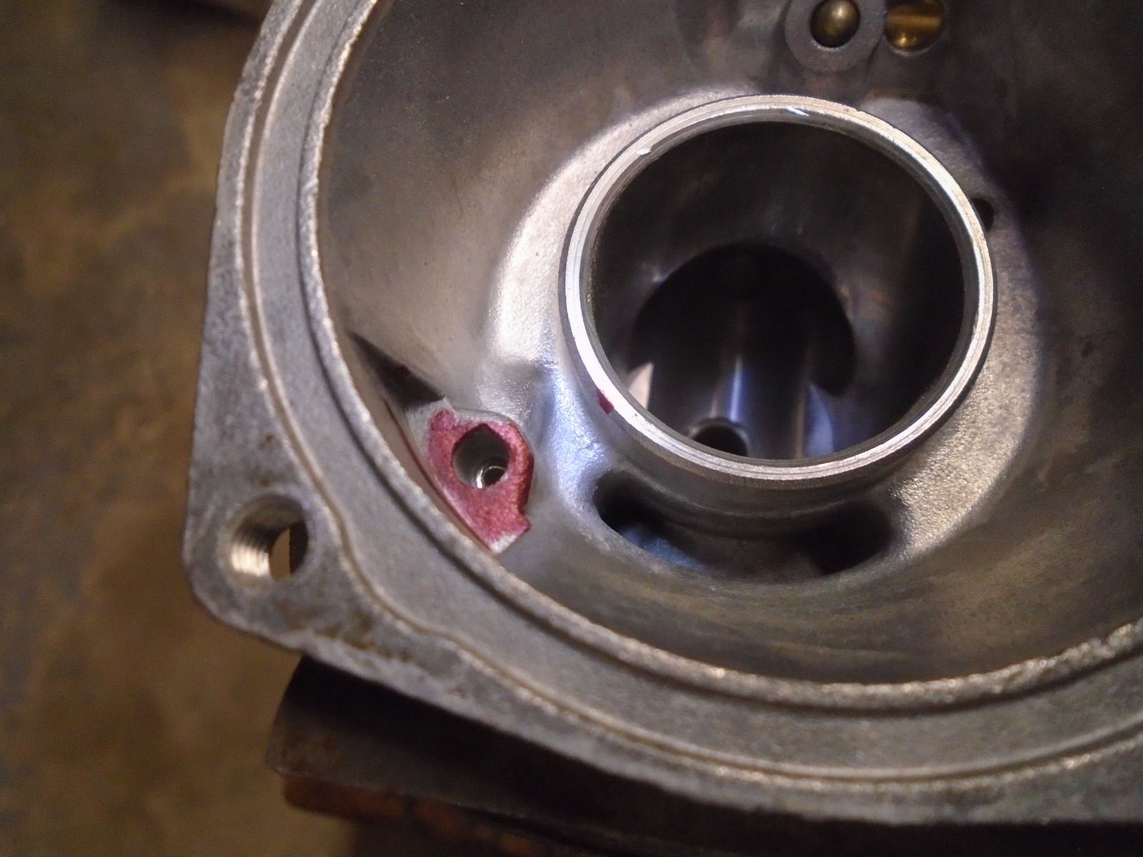

Bound, pertaining to the reason/function of those J carbs having (2) air jets instead of just 1. It's all because of the Coasting enricher/Air-Cut. In Honda world, because they have been using them for years, Air-Cut is more of a correct terminology because that's what they do/cut air. You'll note the location in photos their location. One at the intake, one underneath the diaphragm. You have TWO separate functions of that Air-Cut diaphragm, vacuum and metering. Vacuum pulls the little diaphragm out to "Cut-Off/Block" the air rushing in from jet underneath the slide diaphragm, resulting in a richer mixture in pilot system. High Vacuum when engine high in RPMs and throttle plate in a closed position provides this. In normal state of running you're siphoning air from Both air jets. When coming down from a stop that protrusion from air cut blocks off the upper air jet. Anyhoot, something to consider, Clay
