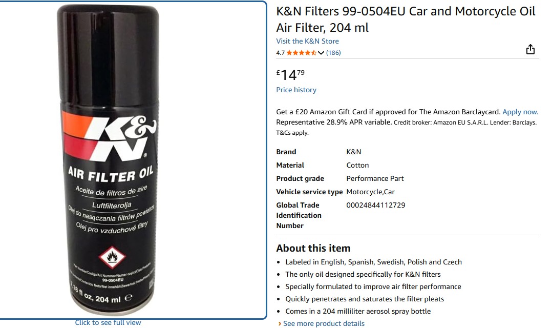

Re: K&n model
05 Dec 2025 06:29
Just tu be sure, are you putting some filter oil on it?! Last time I done that on my Chinese one, the bike was sputtering like missing air!
Kz750e 1980
- Posts: 6940
- Thanks: 4357
Re: K&n model
05 Dec 2025 06:48 - 05 Dec 2025 06:54
Last edit: 05 Dec 2025 06:54 by Wookie58.
The following user(s) said Thank You: Maxbou92
- Injected
- Posts: 1838
- Thanks: 1283
Re: K&n model
05 Dec 2025 13:31 - 05 Dec 2025 13:32
Maxima, Motul, PJ1, and UNI also sell reusable filter spray oil.
Accel also use to sell it, I still have a can from over 30 years ago.
1978 KZ650B2 modified project
Last edit: 05 Dec 2025 13:32 by Injected. Reason: sp

And your bike dont comes too rich with oil?! Like missing air?! Maybe I shouldn’t oil my Chinese pod !! I ordered Rc-2454 KN
Kz750e 1980
- Injected
- Posts: 1838
- Thanks: 1283
Re: K&n model
05 Dec 2025 15:48 - 05 Dec 2025 15:49You need to read this...And your bike dont comes too rich with oil?! Like missing air?! Maybe I shouldn’t oil my Chinese pod !! I ordered Rc-2454 KN
www.knfilters.com/blog/ask-the-experts-a...P0zdkrWUqt7YqhPLCmhE
