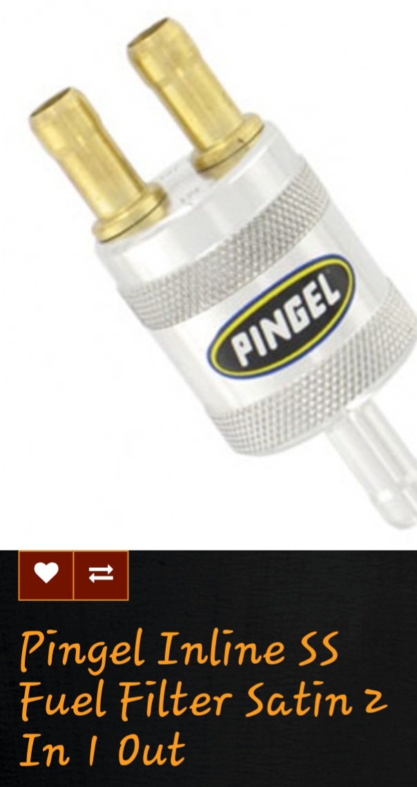

Most of my bikes run the single high flow Pingle petcock and I run the one in two out Pingle filter as shown. One of my bike does have the duel stock outlet petcock so on that bike I run the two in two out Pingle filter that tucks up nice just after the petcock.
