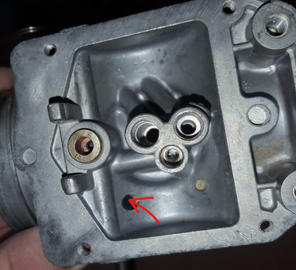

I’m assuming these are my vents.
1981 KZ750e

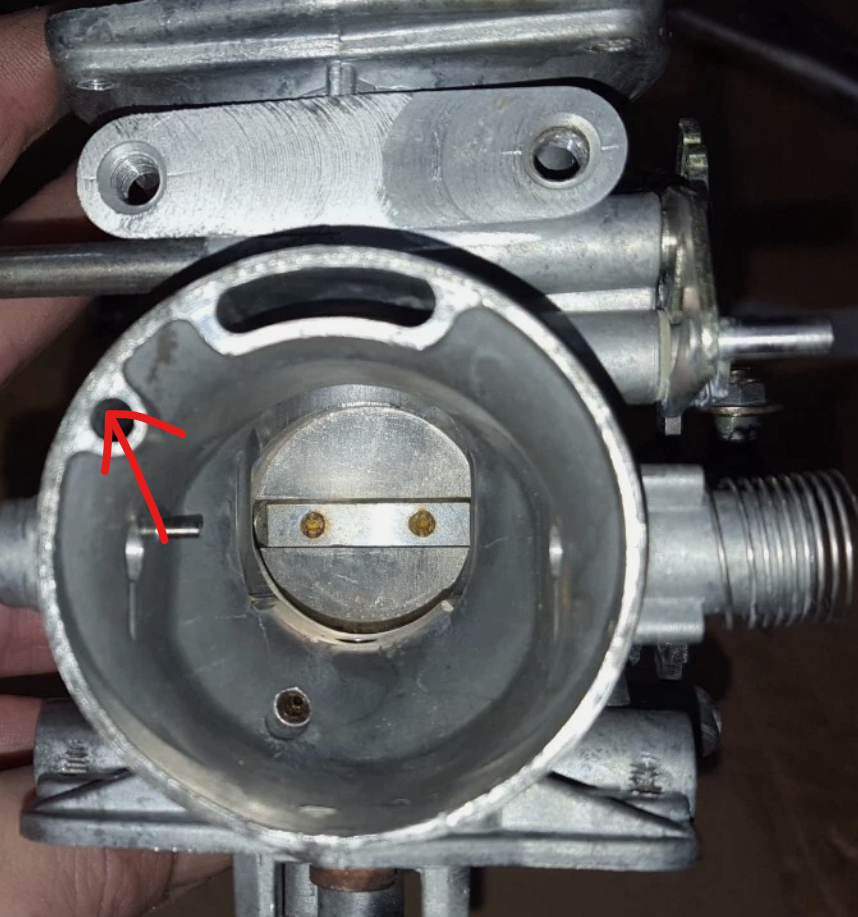

Mine don’t have the tee, so they must be 81 style. Can to track down a photo of what I’m looking for. I can’t seem to find any type of vents
First, look at the carb body.  There is only one hole in the body, from the float chamber.  Put your carb can spray nozzle in this hole and shoot.  It will come out the passage on the inlet side of the carb.  This is the vent passage.  It's very simple to see.
