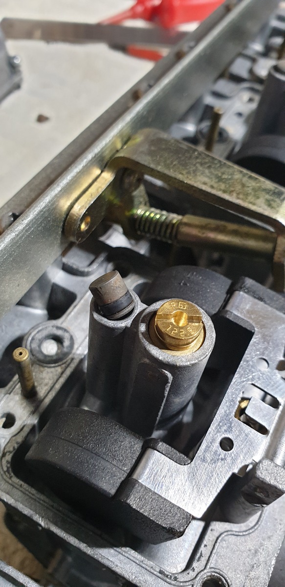

Hi all, I've been chasing a fluffy hesitant feeling on initial throttle openings. I've done valve clearances and a good carb clean ( twice )
the pilot jet next to the main jet has a small metal plug with an o ring, they're really flat and are a really loose fit, they literally fall out !! ive since found out that they should be a snug fit, ive looked on z power and they dont sell them. Anyone know of somewhere i could source them or rubber equivalents in the uk ? My bike is a 81 kz1000 csr using mikuni bs 34 carbs.

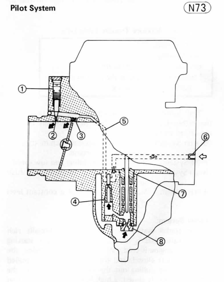

06 Sep 2025 15:08 #916846
by Nessism
Replied by Nessism on topic Pilot jet plugs
- Davey b
Less
More
- Posts: 100
- Thank you received: 9
06 Sep 2025 15:33 #916847
by Davey b
1981 kawasaki kz1000 m1 csr
Replied by Davey b on topic Pilot jet plugs
Thank you Nessism, your always a great help. Being a bit green, how do I use that information ? Sorry to sound dim but this is all new to me, loving learning though 👍
Less
More
- Posts: 8112
- Thank you received: 3494

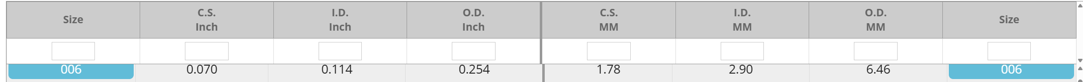

06 Sep 2025 16:02 #916850
by Nessism
Look in your local market for some -006 O-rings. I have kits for sale, also.

07 Sep 2025 08:36 #916866
by Davey b
Thanks again Nessism. I've looked at some online, are all .006 o rings the same ? Only reason I ask is the ones I've seen online are a "round" profile whereas if you look at my picture, mine appear "flat"
Is that just because mine are old and have gone that shape ??
