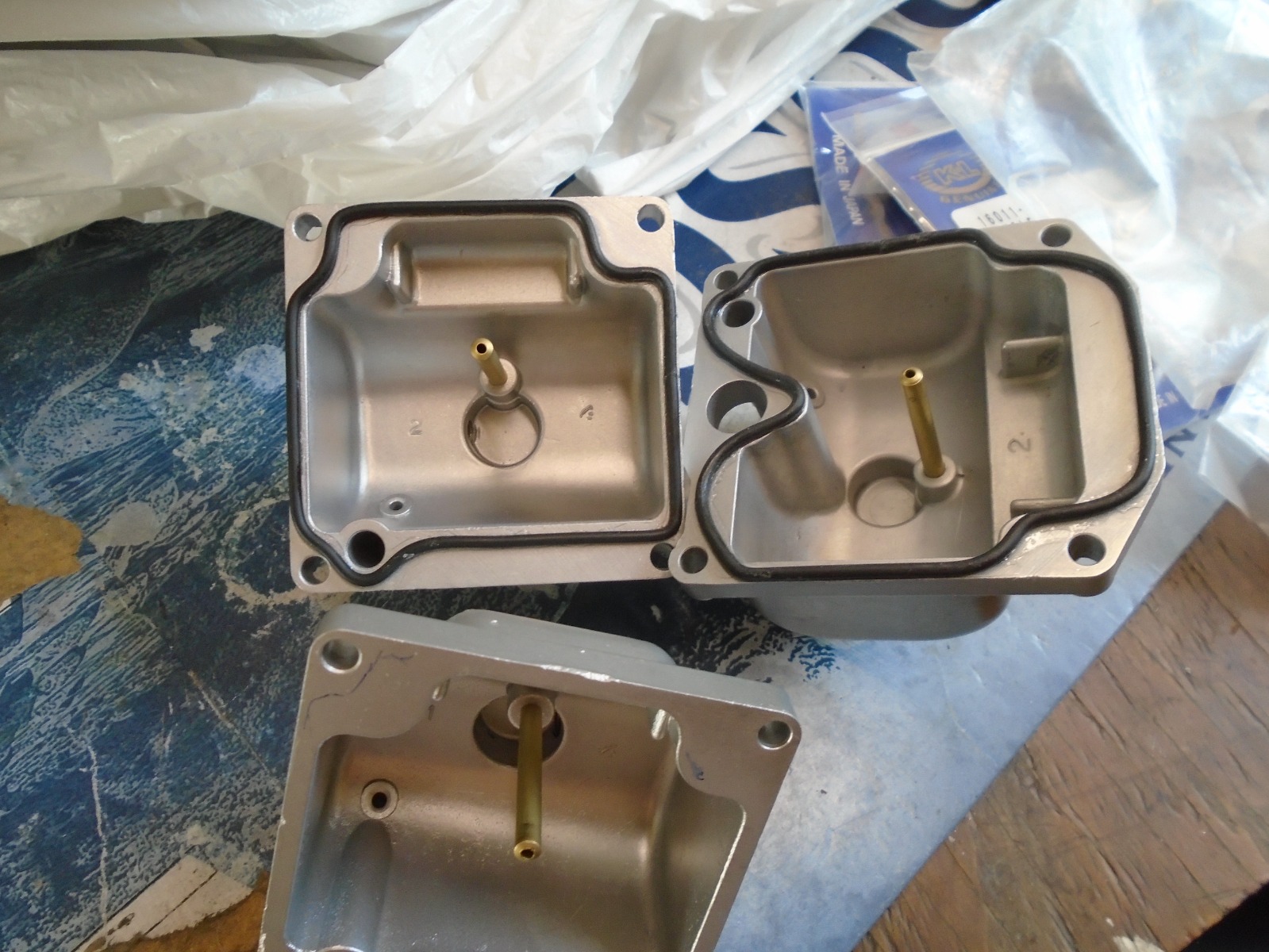

If bowls are weeping enough to smell it when merely sitting then imagine what happens when you're riding and fuel is sloshing around. Those castings warp, not the bowls. Tightening away won't help either. That's why i haven't used paper gaskets for well over a decade.
