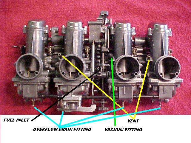

Not sure if this will be of help or not. The attached is a set of vm26ss carbs. I am unclear if your machine came stock with 26 or 28 carbs but either way the ports (vents and vacuum) should be much the same. As a note some carb sets have a single fuel inlet (between carbs 2 and 3) and some have 2 fuel inlets between carb 1 and 2 and between carb 3 and 4. Will say the vacuum port location on vm26 and vm28 carbs is the same, on carb number 3.
Keep in mind depending up what sort of carb holders (rubber flange that connects cabs to head) you have they may also each have a test (vacuum port) located on them. If they are not being used to operate some type of vacuum device they should all be capped.

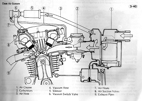

You also mention the clean air system that bikes intended to be sold in the US had. I have included a pic (it is for the 550 bikes) that shows how it plays into this. If your machine has such it would be much the same.
