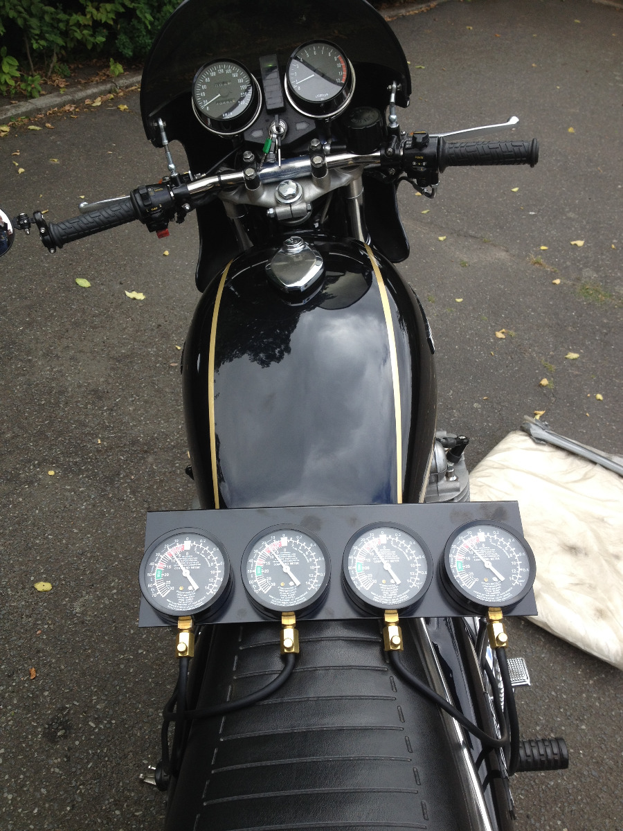

(The engine was running perfectly, as you could see from the pictures of the vacuum gauges, for example,...the only problem was that after longer rides at low revs, plug number 3 would repeatedly become sooty, causing the engine to misfire and only run smoothly again after hard acceleration...

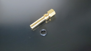

The O-ring between the main-jet holder and the housing was worn out and probably wasn't sealing properly anymore! This was causing too much fuel to enter the intake port, and "blow the sparkplug out" bye continue too much fuel...?!
After renew with a new o-ring and complete the carbs again, the engine runs well, with a "brown" sparkplug, and normal acceleration at lower rpm`s...so i am happy again

Where did you buy the o rings? What size is the o rings?

I´ve found one that have fit in my o-ring sample , sorry, no actual size to report ...but i am pretty sure, the specialists here, like zed1015, ( Rob), or asphalt900, ( Clay), or Nessism, can help with the correct measurements about!!

...boy, oh boy,..a simple mistake with an O-ring that no longer seals 100% properly...Sure, the O-ring was "formed" by the seat, but it looked round, but unfortunately it obviously wasn't properly sealed.

13 Aug 2025 09:26Nessism supplies quality "O" ring kits for very sensible money

Yes, I sell O-ring kits.
Since I've started selling O-rings in September 2022, both VM and CV type, I've sold 163 sets for Suzuki GS bikes, and 32 sets for Kawasaki KZ bikes. Why the disparity? I don't understand.
