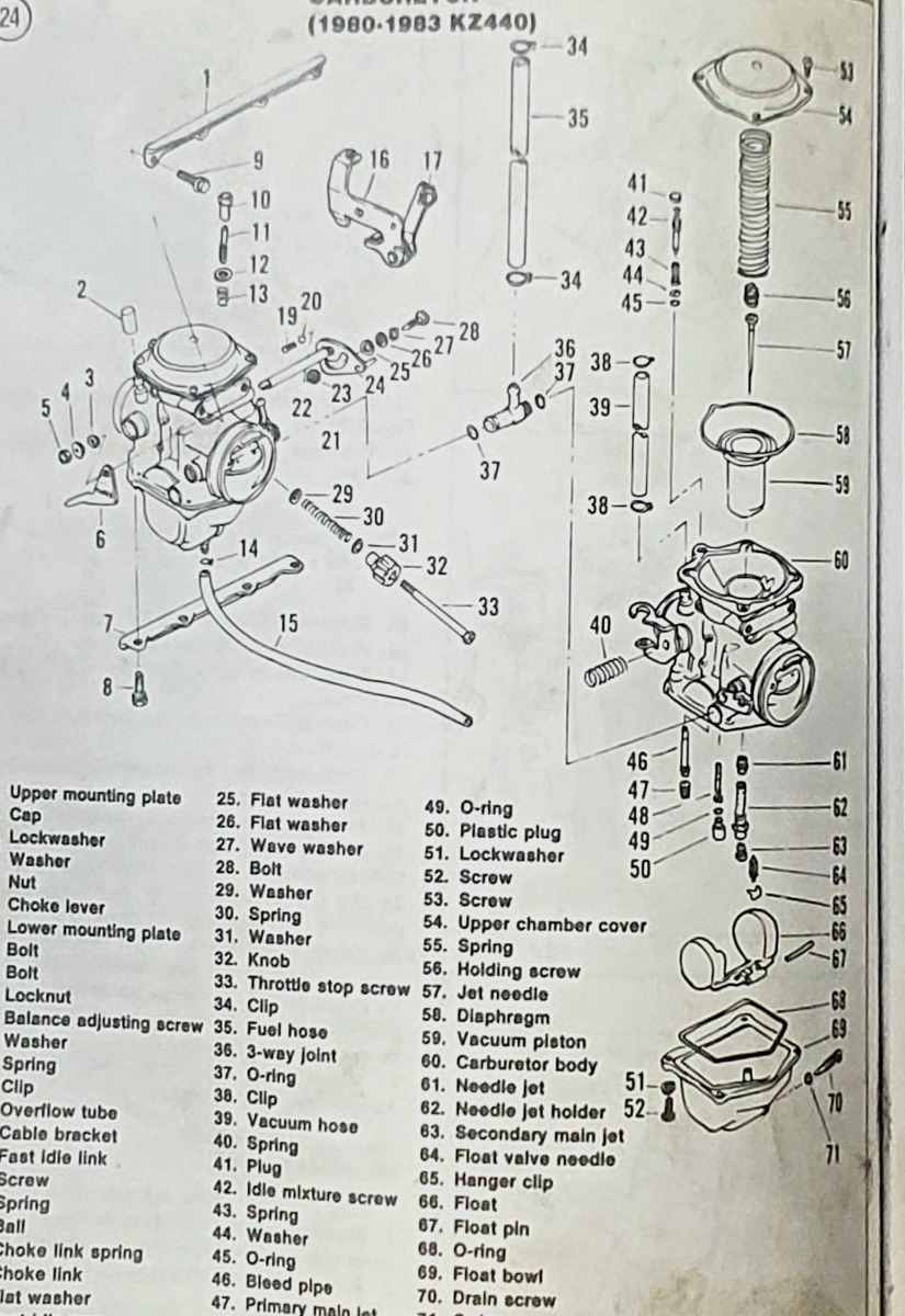

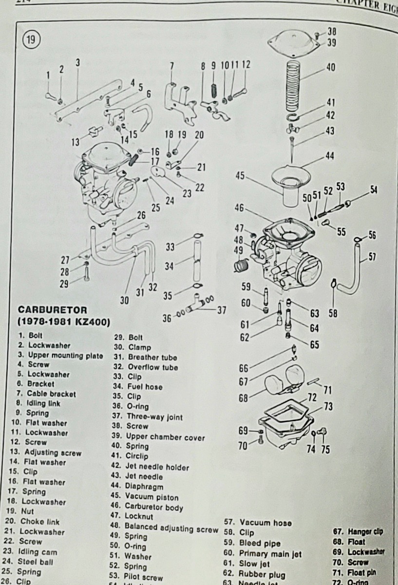

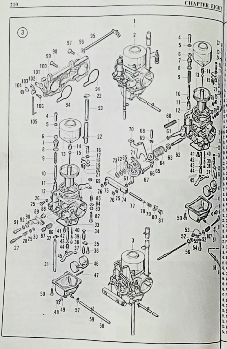

All,
I am a f**king idiot - I stupidly decided to completely strip down to a nut and bolt level my CV36 carbs on one of my KZ440 Ltd and now I cannot find an exploded diagram of the left carb so I can see how to put the choke back together - does anyone have a parts fiche, PDF or any other breakdown showing the rebuild instructions for one?
don't get me started on how much I am a t**t for not making notes 🤬
any help would be appreciated!
Simon
Simon

Re: CV36 twin carb setup on KZ440 Ltd - help needed
06 Aug 2025 13:08
I do not know which year and model you have, so if this is not correct, search Partzilla for the correct one.
www.partzilla.com/catalog/kawasaki/motor...0-g1/carburetor-assy
07 Aug 2025 04:24
Once again - this forum comes up with the goods!
thank you Nessim, TexasKZ and KZEnormous - I think that this will help me get the choke mech Back together - I owe you all a beer!
Simon
