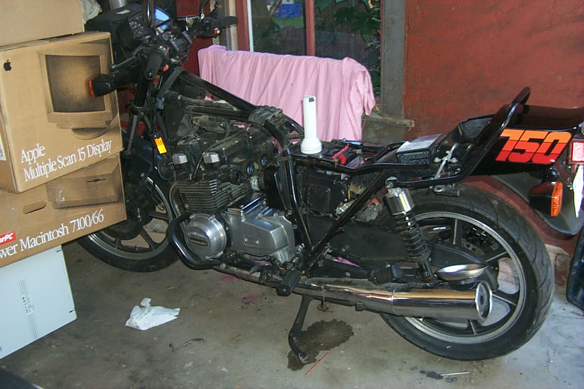

1983 KZ750 L3.
It'll be moved outside, filled with fuel and given a test start. Carbs are clean, fresh battery and plugs.
I forgot to hook up the vent tubes on the carbs; but other than that it should run. Wish me luck.
I've owned this bike since 1990 and it's the first motorcycle that my eldest son rode on when he was just a tot.
Still can't get the front brakes bled. I think the China front master is not pumping.
Photo from 1999.

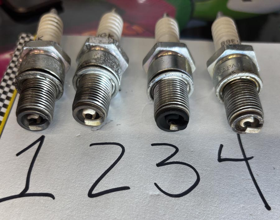

It started and ran. IR temp on # 1 cylinder exhaust pipe was half of the others. Ran like crap. Carbs/slides hanging when give it throttle. Crank idle way up to compensate and let it get up to temp. Ran worse the warmer it got. Drained the carbs and it'll go back on the bench. Will pull plugs to see what they look like.
