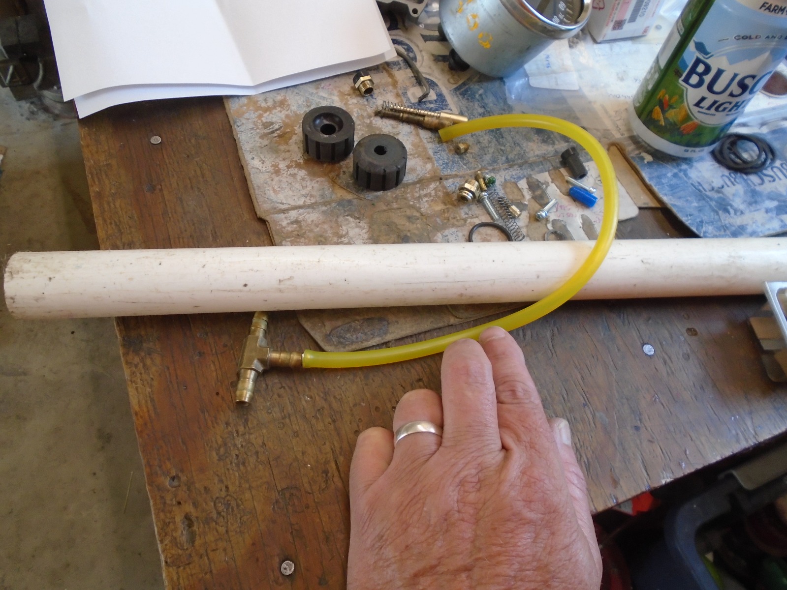

I use a chunk of ABS pipe. 2.5" diameter or so, 24" long. Exact dimensions are not important. Glue on a matching end cap, then drill and tap for a threaded nipple fitting, for the fuel line.
To hang the pipe, a piece of stiff wire, formed into a hook shape. When hanging your tank, it needs to be above the carbs, but not too high, or too much pressure head will be applied.
Been using this for years. Total cost: cheap! Ha ha.

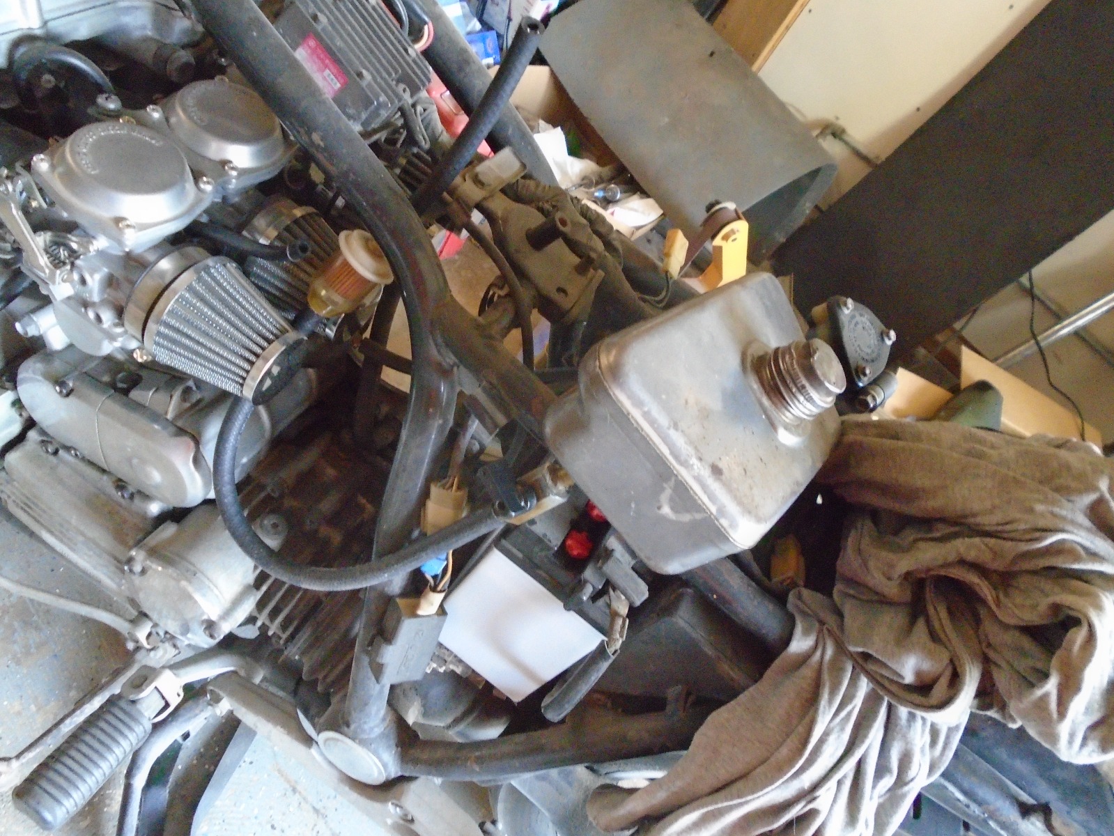

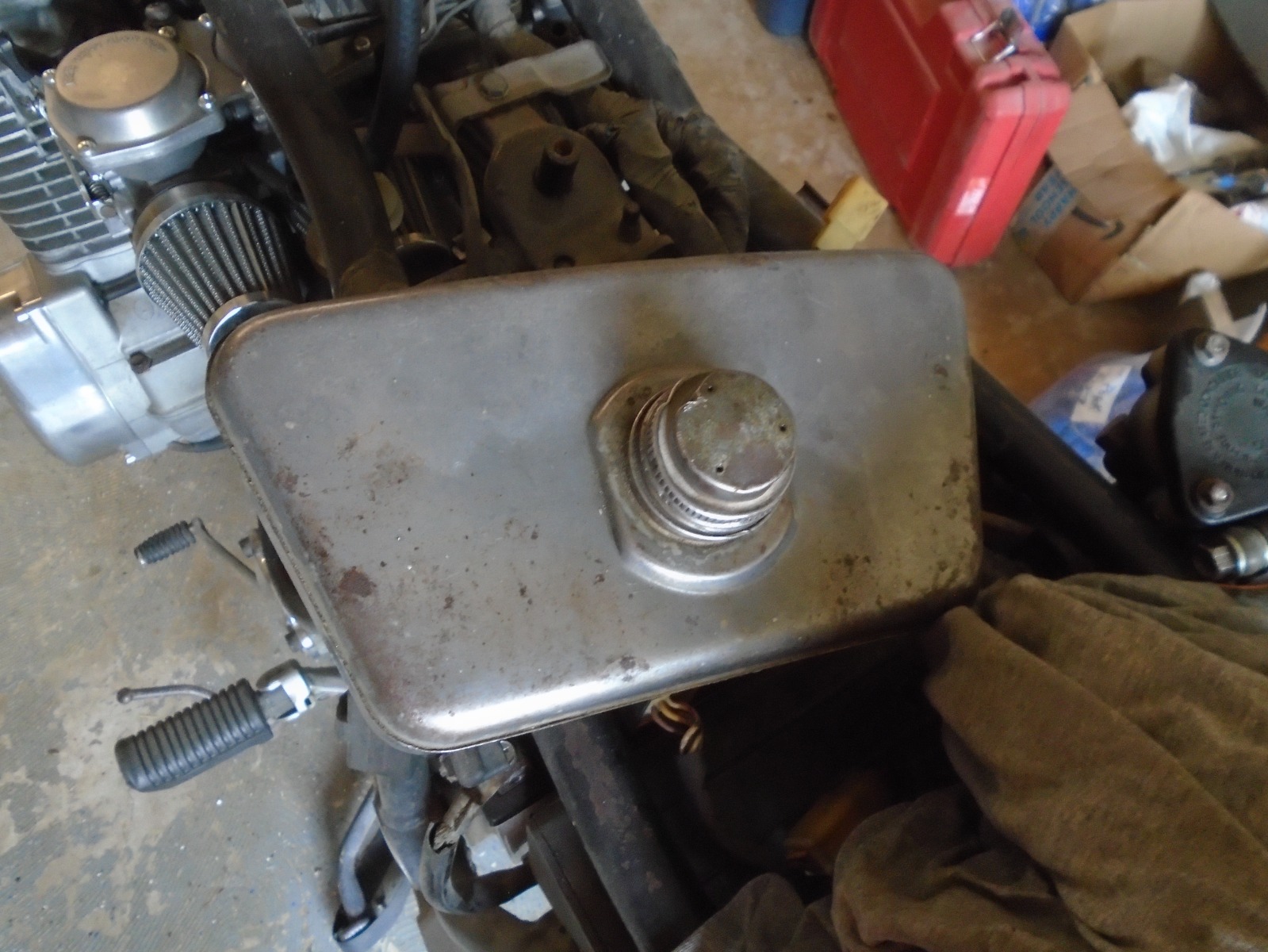

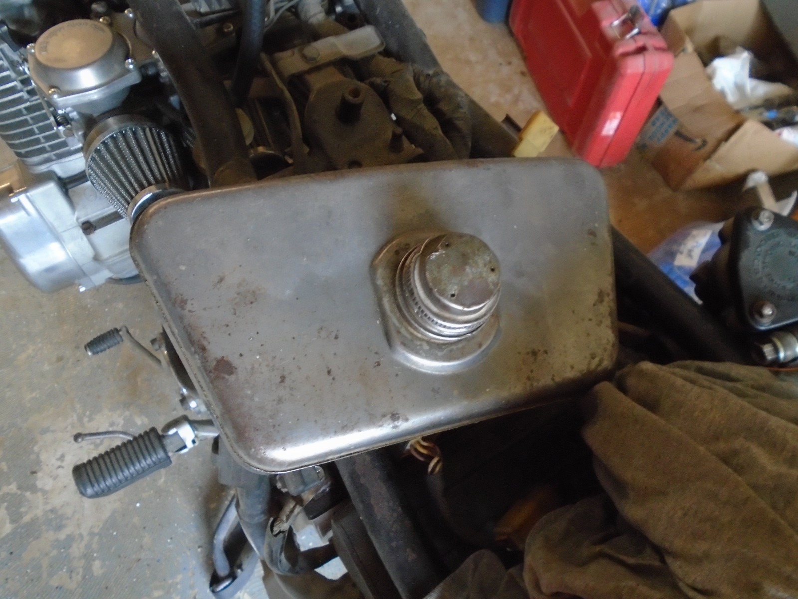

It won't dangle from the bars and certainly not fancy but have had this remote petrol tank for well over 20yrs, works perfect for multiple applications. An old Tecumseh seem brazed tank slightly modified. YES, lawn mower variety. I don't trust those "motion-pro type plastic ultrasound welded tanks. I've a couple new plastic 5gallon tanks that are breaking from the seems.

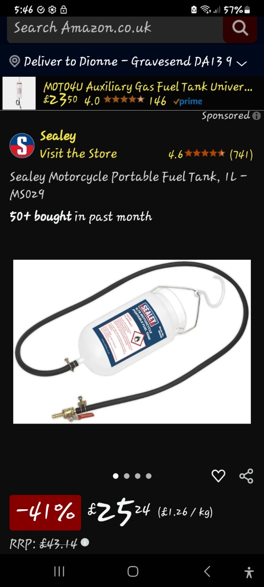

Been using one of these for about 20 years, still going strong.
I'd imagine it's just a badged generic from China so could be bought loads cheaper.

Had never thought about that, because never needed it but i'm Digging the concept!! One also incorporate an elbow with some sort of translucent hose to show the contents. A quick grab of bits but You can see ED's Idea. Technology straight from the woodpile, ha.

And about 15USD to build or Cheap as Ed noted!!

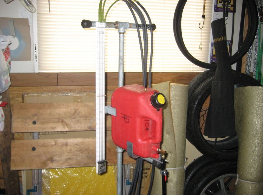

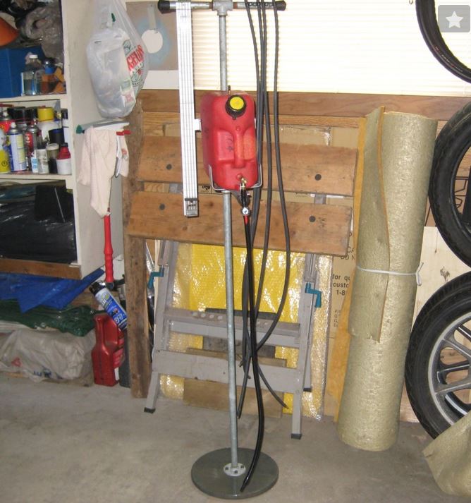

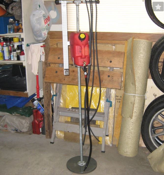

I made up this little 1 gallon auxiliary tank stand about 10 years ago with stuff I had lying around the garage, other than the shutoff valve it was free.
