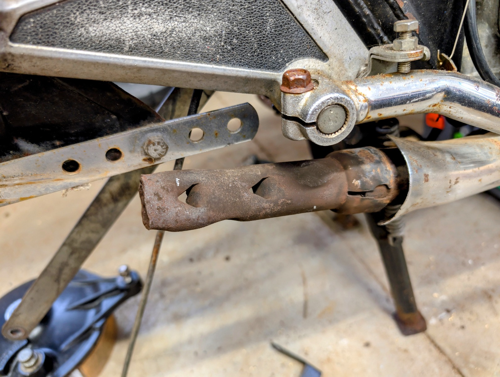

You say there are baffles and silencers. What sort of silencer do you mean? A picture or two might be helpful.

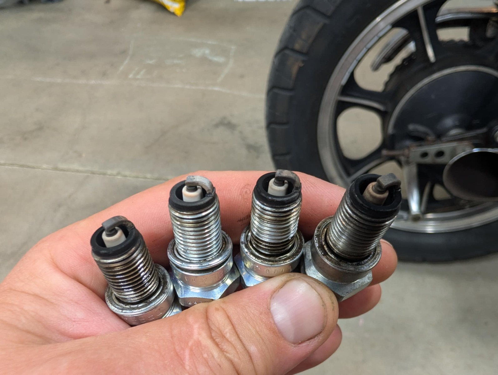

What do the plugs look like?

As to the exhaust, bear with me. It's chintzy, I struggled with keeping it like that, but it's my dad's old bike and I wanted to preserve it as best I could...I had to resecure everything and it's good now. I know the correct thing would have been to replace them but those warm fuzzy feelings of my childhood made me spend hours making it work
It has those silencers that Harley guys put in the exits of the pipes...but these have been flipped around, chopped, ends welded and the go over the exhaust pipes. The muffler slips over it. The muffler is some off brand, but it does have baffles in it.

#4 is an older plug, hence why it's a different colour. I had put new plugs in and within a few kms that plug started acting up. I fired in an older one until my new ones arrive. This picture is after maybe 500kms or so.

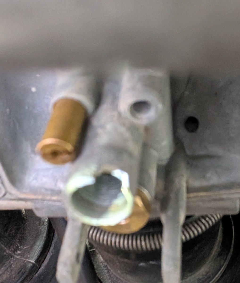

Pulled bowls off...and I had forgotten about this
When I initially pulled these apart, there was a piece missing from the main jet post. I presumed it had been like that when my dad rode it, as I didn't find any pieces. So I figured I'd keep it in the back of my mind. I didn't. The o ring for the emulsifier tube had come apart at this broken spot.

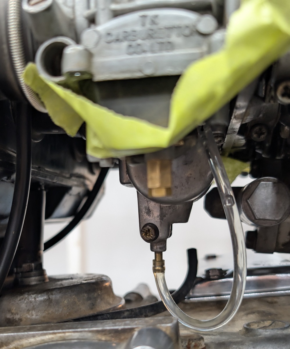

Mulled over my options...JB weld seems to be a hit or miss repair. Some folks have no issues with it in a carb, others have. So I did both....mixed up some marine JB weld, and repaired it, using a piece heat shrink tube as an inner guide. 2 days to cure. Re verified the fuel height. Took it for a drive, all of the weirdness is gone, bike drives great.

Also, since I was doing all of the carb stuff with them still on the bike, I taped up the floats for the outside carbs so that I could access the bowl in #3 in case I had to re adjust the fuel level. It worked!
