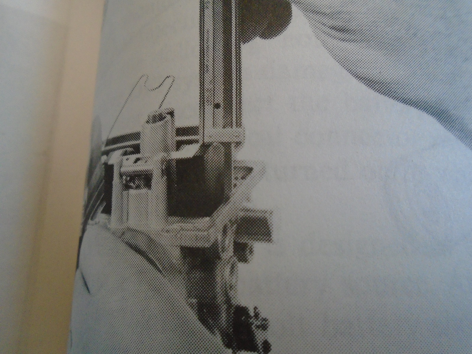

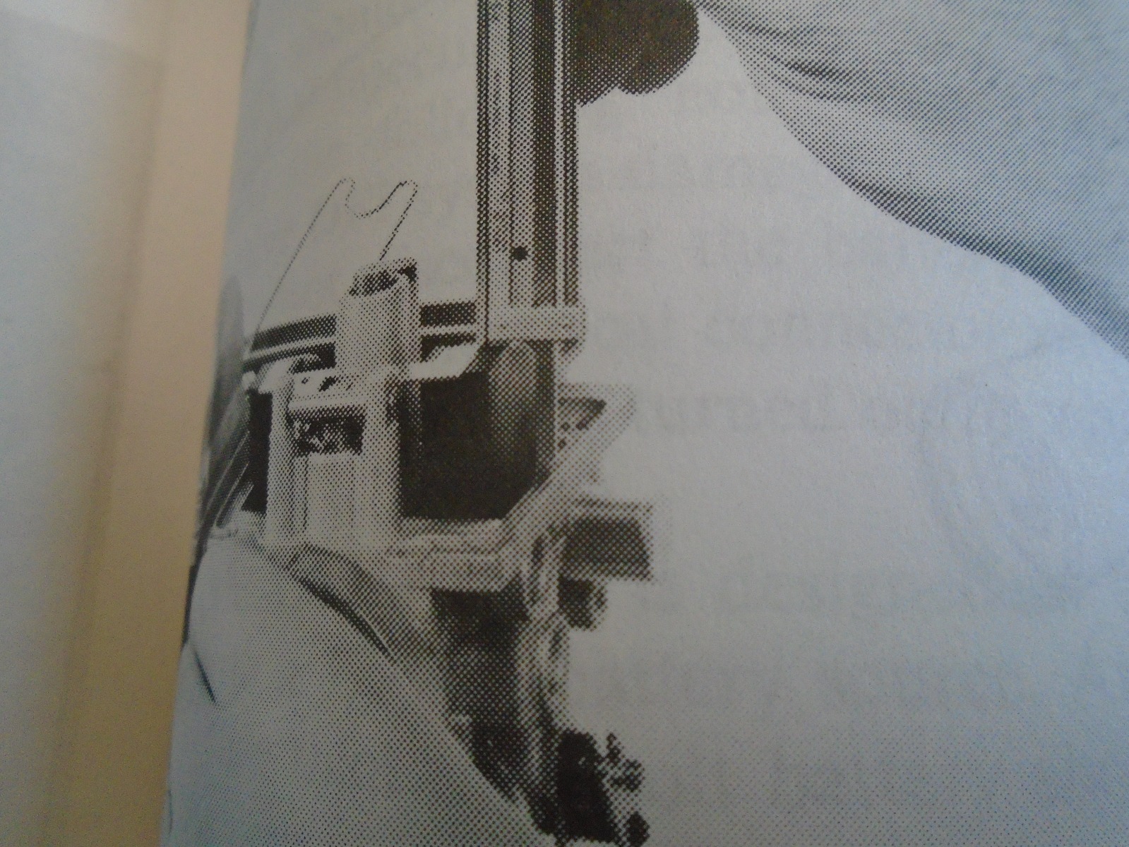

Oh NOOOO, ha. Here's the procedure if you have the correct, for your model/year, KZ750 BS34 Mikuni's. Easy to tell, early 750's had choke flaps not choke plungers. Don't measure with gasket and don't measure with full weight of float compressing needle spring. tilt the assy till float tang just kisses the needle.
