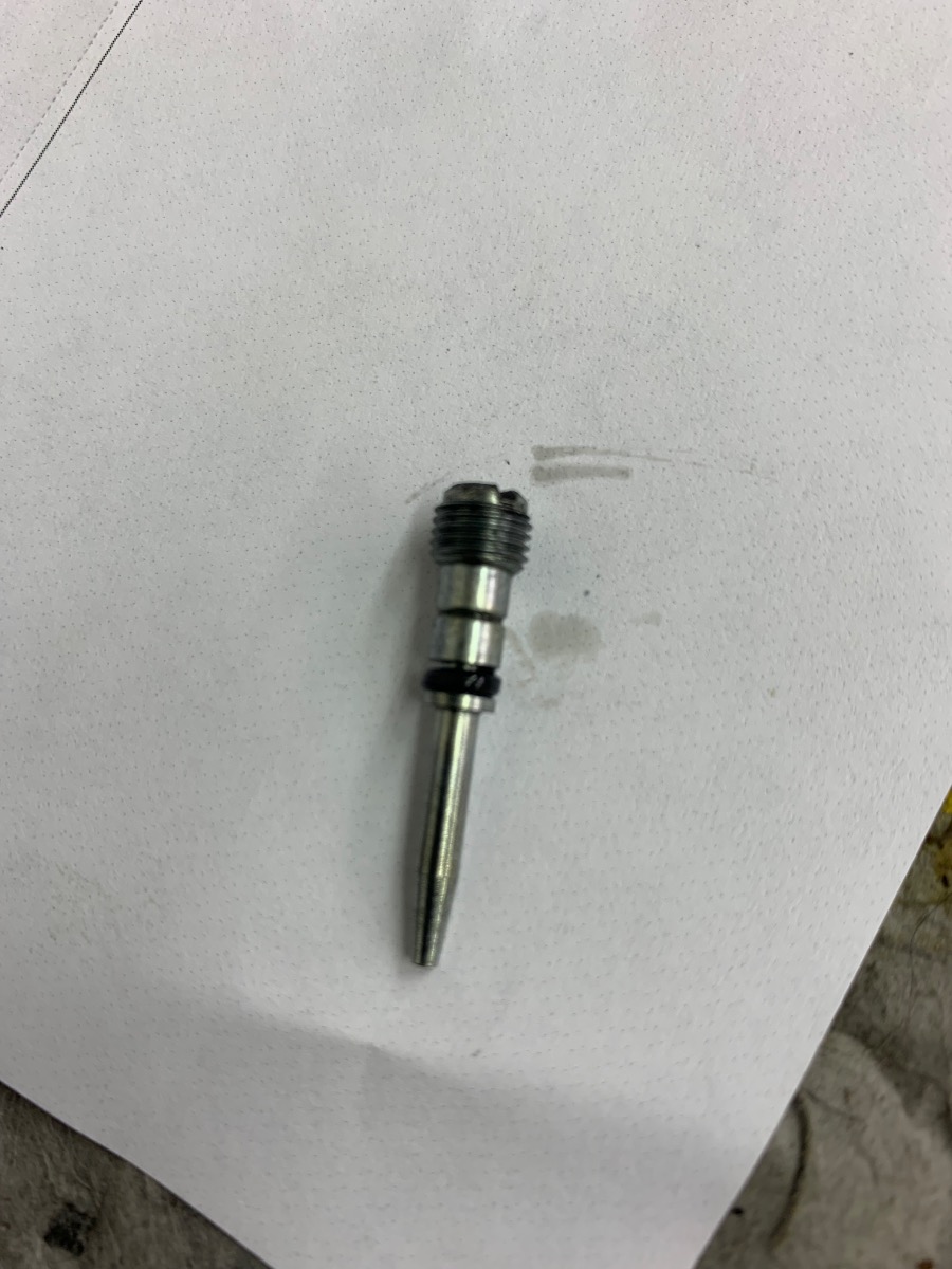

Forgot to mention. Yes they did have a Steel air adjust screw but it had a different part number 16014-017 and was generally used on the later model VM's.

- mvent
- Posts: 242
- Thanks: 28
- asphalt900
- Posts: 1968
- Thanks: 1322
Re: Carb ID help
13 Jul 2025 06:55
See, You have as shown the, 16014-017 (steel version). Those "original" Z1200's didn't come that type of material, only brass. The 16014-1004 is the brass version equivalent. I can't speculate to the taper differences though? Perhaps the casting hole is different where the taper resides? Too big, spring would coil bind. Too small, spec settings would be different and screw would not be screwed in as much. You could do a vacuum test to verify flow differences? Or maybe that's not available to you?
