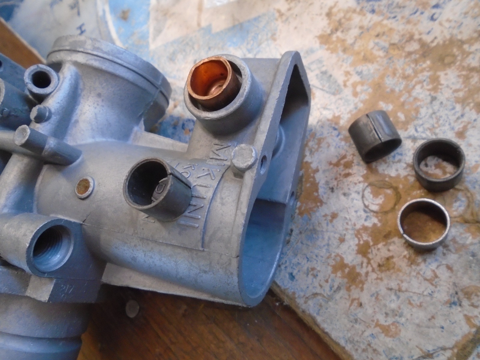

And some additional info if it Helps mvent? Don't give up completely on those early Z1 carbs yet! They follow a different path to success. I do quite a few of them Z's AND the CB350/400/500 and 550's that have the exact same issues because of the same design. You never mentioned which version of the Z carbs you had? They had 5 versions. The early ones had #4 carb adjuster..well non-adjustable. I change those out for adjustability. Waay too often overlooked are the TWO sleeves/steel&teflon sleeve (2) for casting lifter. They are pressed into the two sides of the casting. They don't like those "ultra-sonic" cleaners, you'll rattle that NECESSARY bonded teflon bushing right out of them!! Without that sleeve, you'll never be able to set them. I mention it because You said a dunk in the sonic.. I Never use an ultrasonic on Any carb set i do, totally unnecessary and gives a false initial promise of clean.

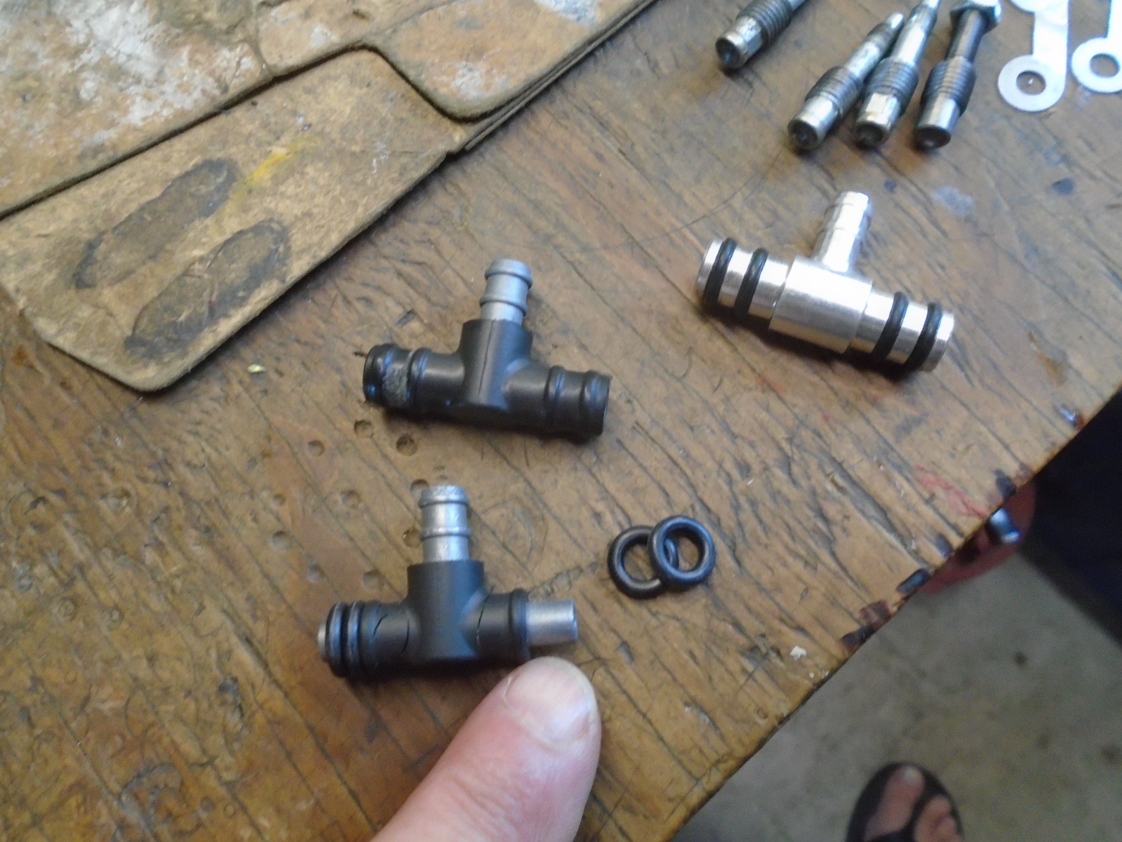

Here are the sleeves and tool to remove if necessary. Also You mentioned you need a Fuel Tee. I've been reusing the originals for years. Just cut away as shown and add a couple #78 O-Rings for replacement. Note the extra one shown that are available, totally unnecessary. There's Your ham sandwich, Have Fun!!

Asphalt900, carbs are Z1B all four slides are adjustable. Had everything stripped or so I thought, but not those sleeves before ultrasound. I will reuse the one original fuel tee, missing the other, I see they are available oem but pricey. Have an old can of Berrymans probably try that with these carbs.
