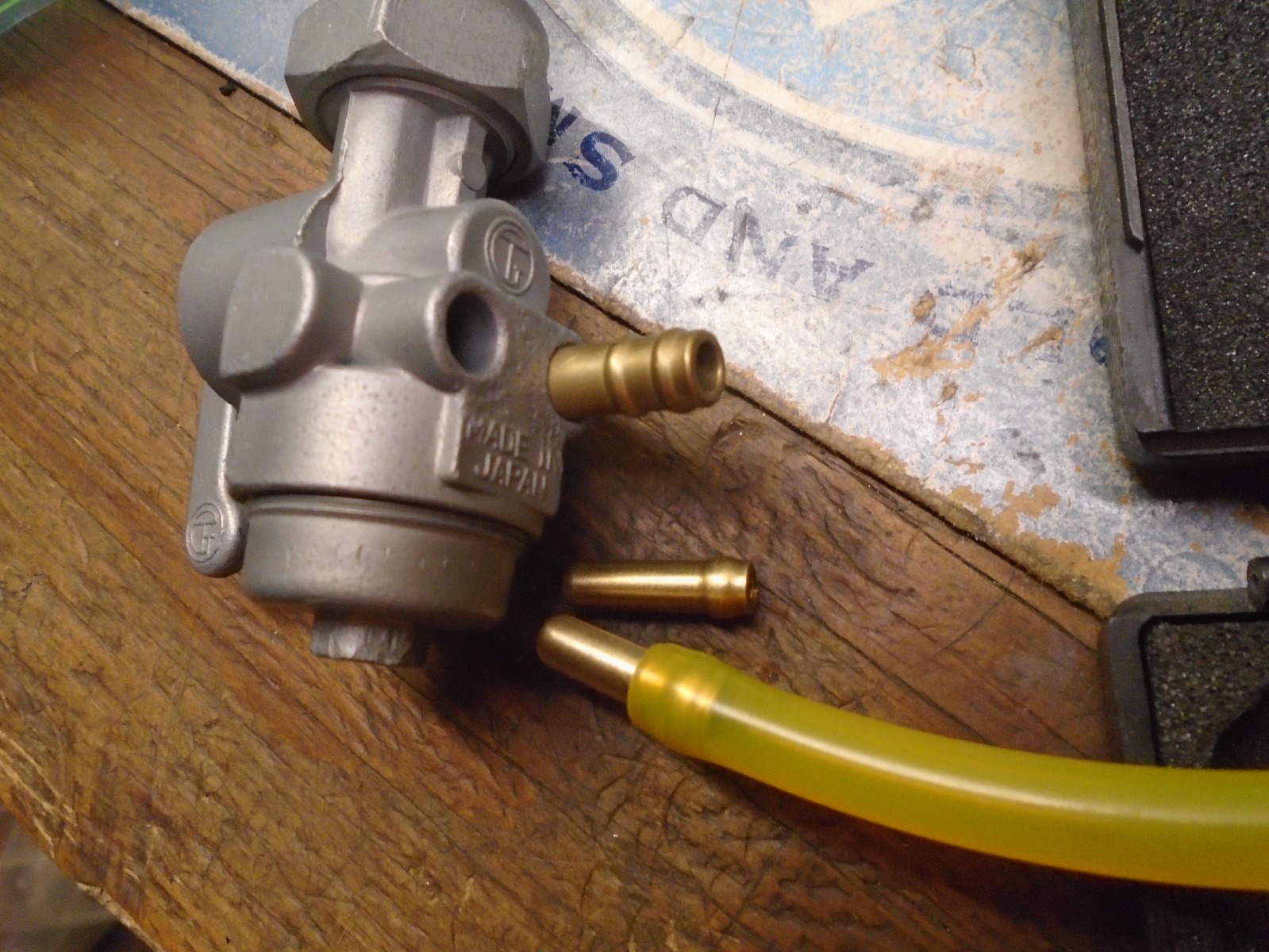

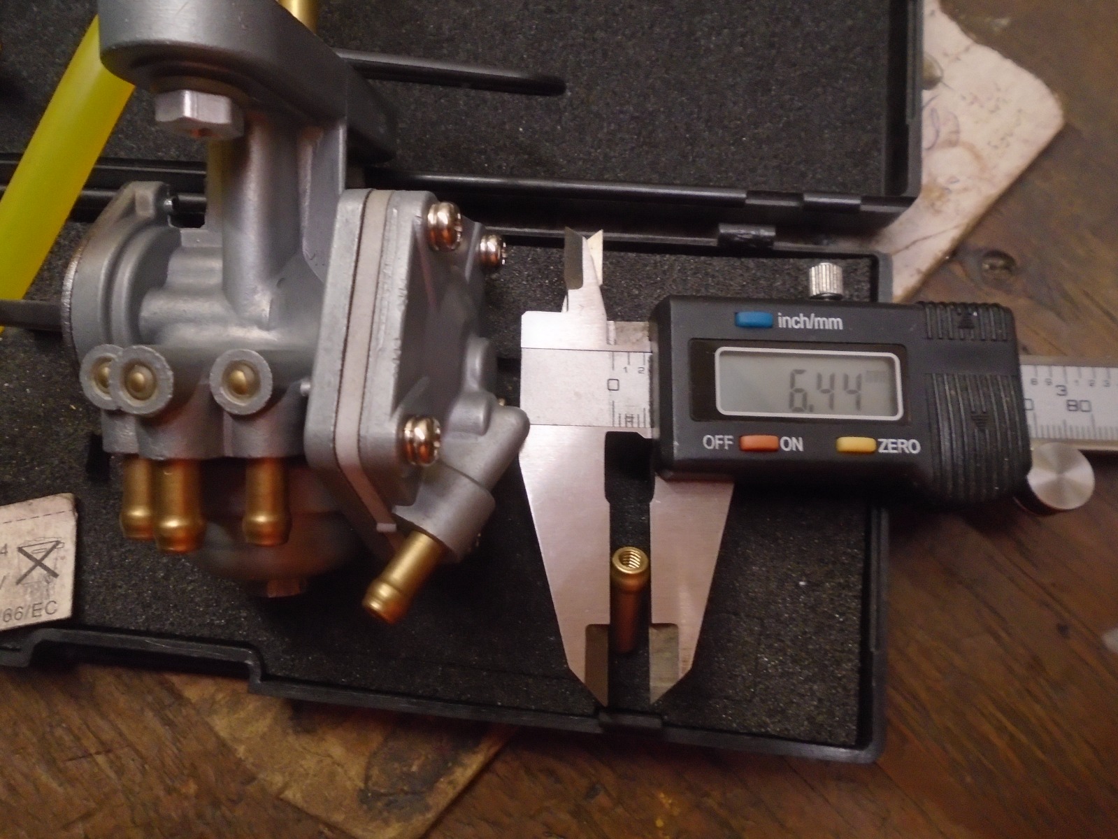

You have the smaller size, 5.5 X 6.4ishmm. A couple companies dominated the Petcock market back then, Mikuni or Taiyo Giken as supplied thru various brands. I'm betting you have the TG product. Ed is Correct for the Suzuki Hose but it only fits the Larger 7mm style barbs. If you're not concerned with a splash of color, use 1/4' Tygon fuel line. Readily available at "most" hardware/lawn mower shops. Like the hose Ed mentioned and original, it's thin-walled so assembly won't be a fight. It also is a friction fit but would suggest some sort of clamp. Tygon shrinks as it ages, contrary to what most person's don't care to admit. A couple of pictures to help you distinguish the difference, Have Fun!
