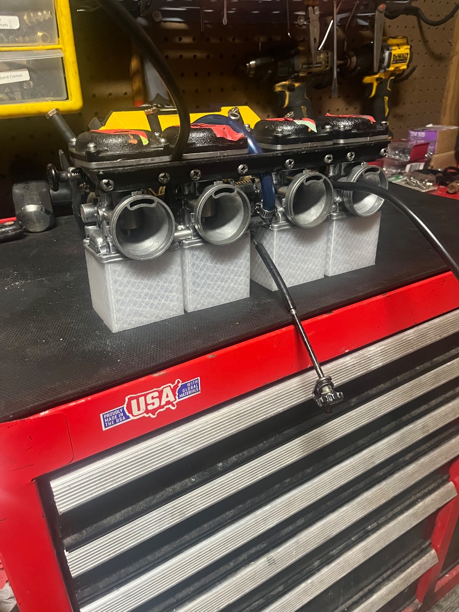

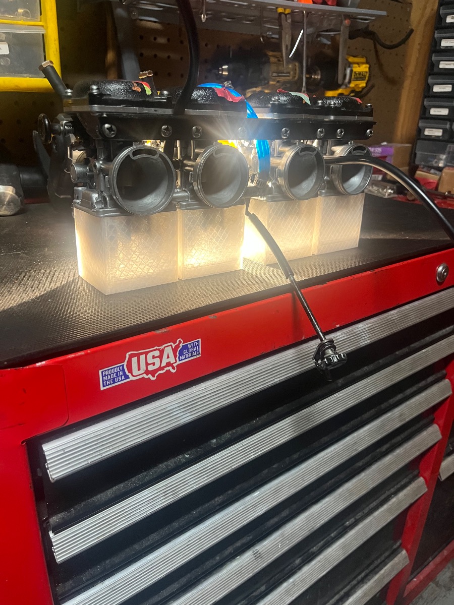

After frustration with air bubbles and inconsistent fuel level measurements using the clear tube method and inspiration by a guy named ADV rider on YouTube I decided to try to 3D print some bowls for checking fuel level measurements. Good way to check fuel flow as well. I spray them with clear coat and they have held up well. Apologize for the quality of the pictures. Maybe I’ll try to get new ones.

These look a good way to test all four when off the bike before the install, are you looking to sell sets? It would be good to see close ups of the full levels when the floats close the valves👍

I will try to get the pictures your suggesting. Haven’t really given much thought to selling but if anyone is interested I could see making some.
