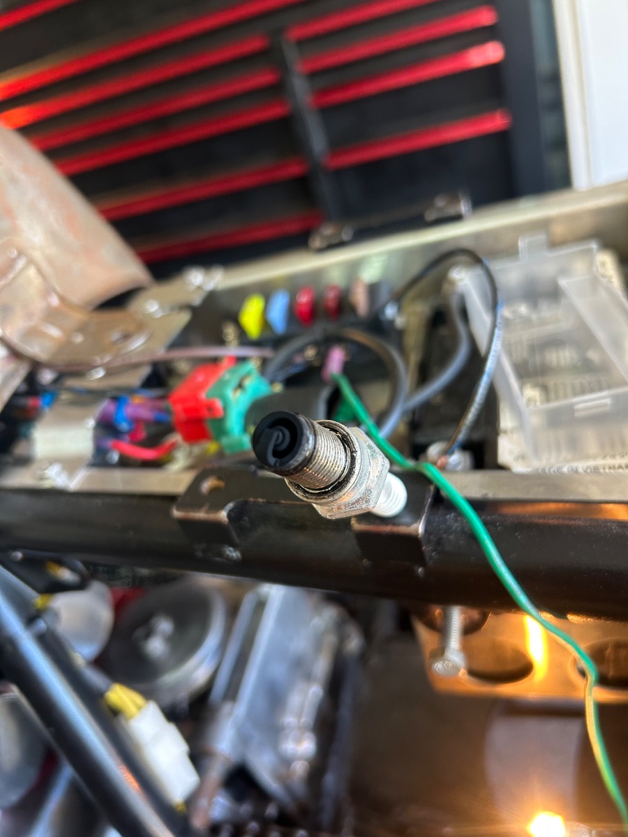

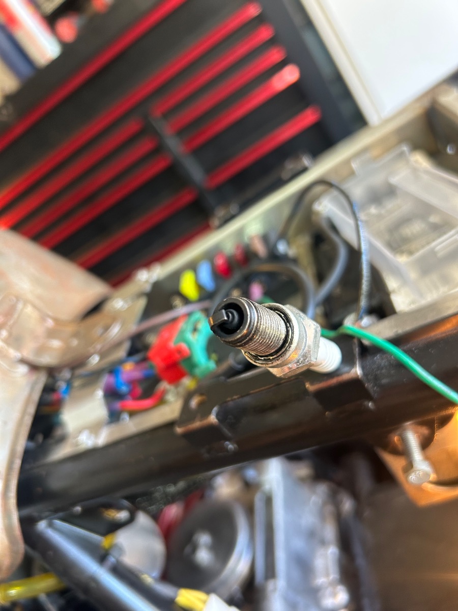

Pictures are of the spark plugs from one of the cylinders. Both pictures are the same plug just one I wiped off the carbon buildup.  All look relatively similar. However, the bike is clearly running rich,  and the plugs have looked that way even when I had pods and stock jetting and just got the bike to run.  It now starts on command with no choke, nor will it run on choke, or start on choke. It's got mains drilled to 100 and 37 pilots. there's a minor hiccup when twisting throttle from idle to mid range quickly but it responds great afterwords if not aggressive revving it and it goes to about 5k where it breaks up. The air fuel screws do not seem to do anything (ports are verified to be clean). I will be getting replacement pilots to start from stock again but even with pods the bike doesn't seem to want to run lean by the look of the plugs. Any advice here? I know people recommend shimming the needles, but that would make the bike richer in the top end and I'm not entirely sure I need that. I have the stock mains too in the even I need to redrill those to a size smaller than 100. (No air box and I don't plan on getting one)

Unless there are other issues the rich running being unaffected by the air screw indicates that the pilot jet is too big..
