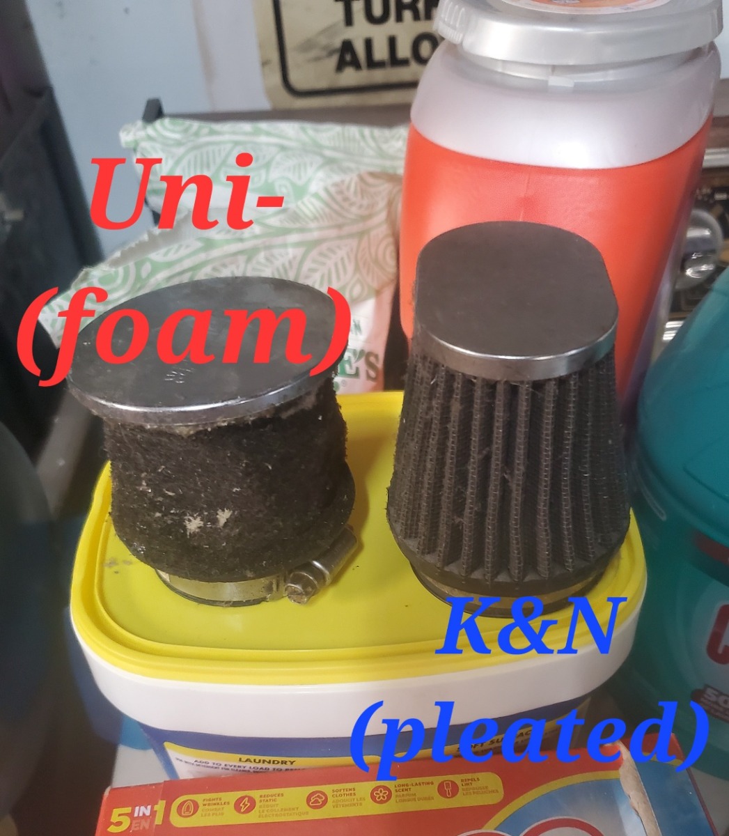

Both the UNI (which is foam) and the K&N (pleated) are reusable, that is you can wash them, oil them and go. Having used both types, I prefer the K&N or APE over the foam UNI. Here's a very dirty example of both

27 May 2025 13:55Both the UNI (which is foam) and the K&N (pleated) are reusable, that is you can wash them, oil them and go. Having used both types, I prefer the K&N or APE over the foam UNI. Here's a very dirty example of both
Thanks. The K&N is slightly more sophisticated looking. The uni would make my bike look like a lawnmower.
