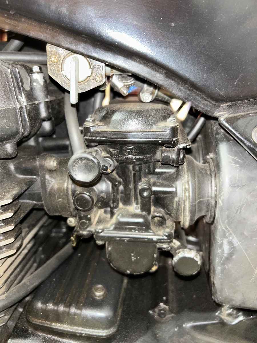

Took actual pictures of my carbs. Still on the bike. Learning that things actually have names on them. 😆
Turns out the carbs on my bike are TK carburetors. I’ll attach a picture just in case I do actually have it wrong, which is possible.

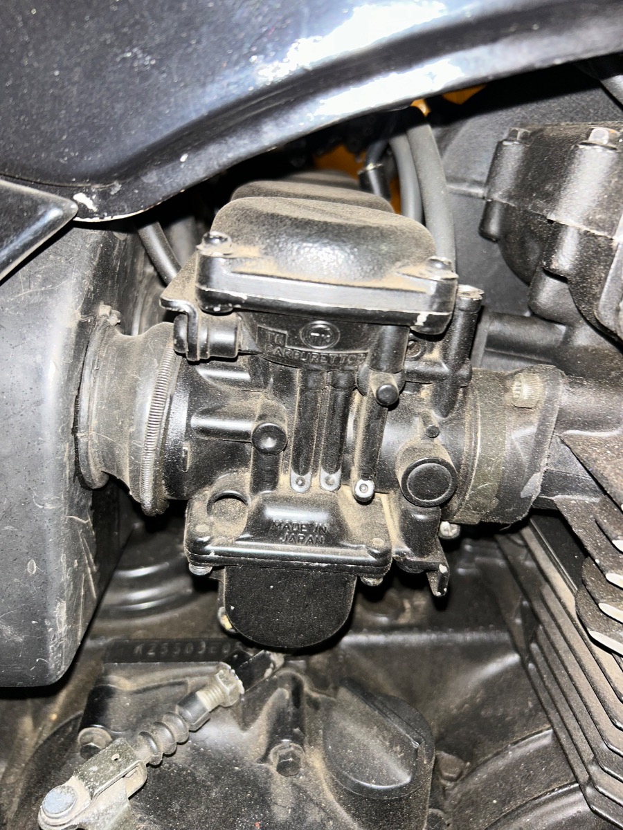

Those are TK carbs and I do have a question about them. In the second pic you posted (from left side of bike as you sit on it) there appears to be something (might be ID) stamped just above the float bowl / carb joint. I can not read it no matter how I attempt to alter it. Can you provide what may be there?

Thanks for the pic, but no I was asking for the info just above the float bowl not the top of the carb.
