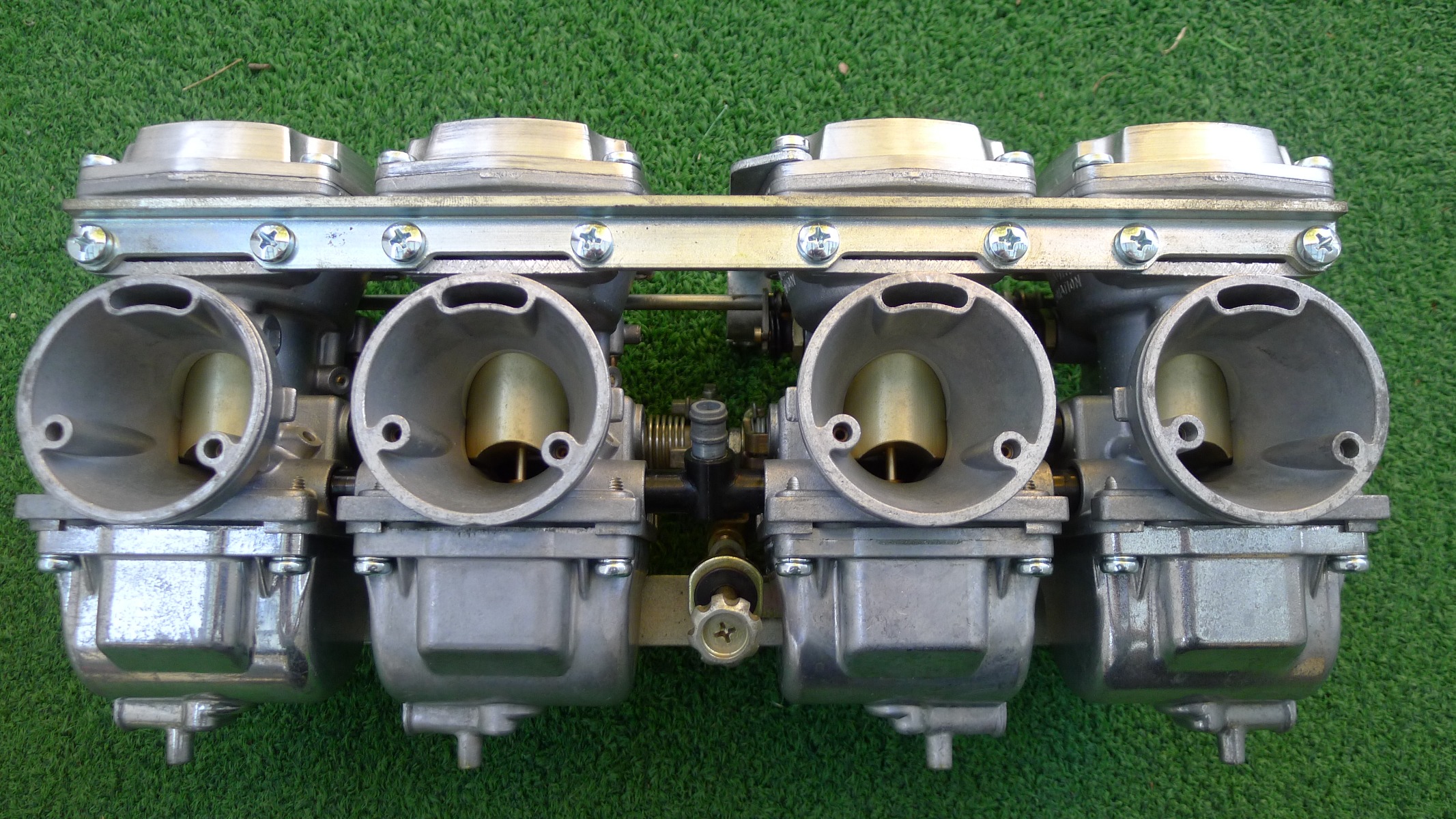

The slides are rounded across the bottom. And the air box side has the one port across the top for the slide operation, and one port to both side of the bottom.
every carb has a vacuum port.
it uses the pull knob style for the choke shaft, with detents.
the bowls are the bottom drain with side screw style.
the only markings on the carbs is “mikuni” on one side and “made in Japan” on the other.

Re: plugs over pilots, no passage to main
05 May 2025 16:33
- KeylAmi!
- Engineer with ADHD
- Posts: 116
- Thanks: 73
05 May 2025 16:50
Yes. Sorry for the confusion. That’s what I meant by rounded. Those look like my carbs.

@Nessism
If those are the carbs I have, why can't I find a passage from the main to the pilot? Do you know how far down into the pilot hole that it should be?
also noticed that the caps on my carbs are different. Mine are thin steel. Those in the pic look like thicker aluminum?
