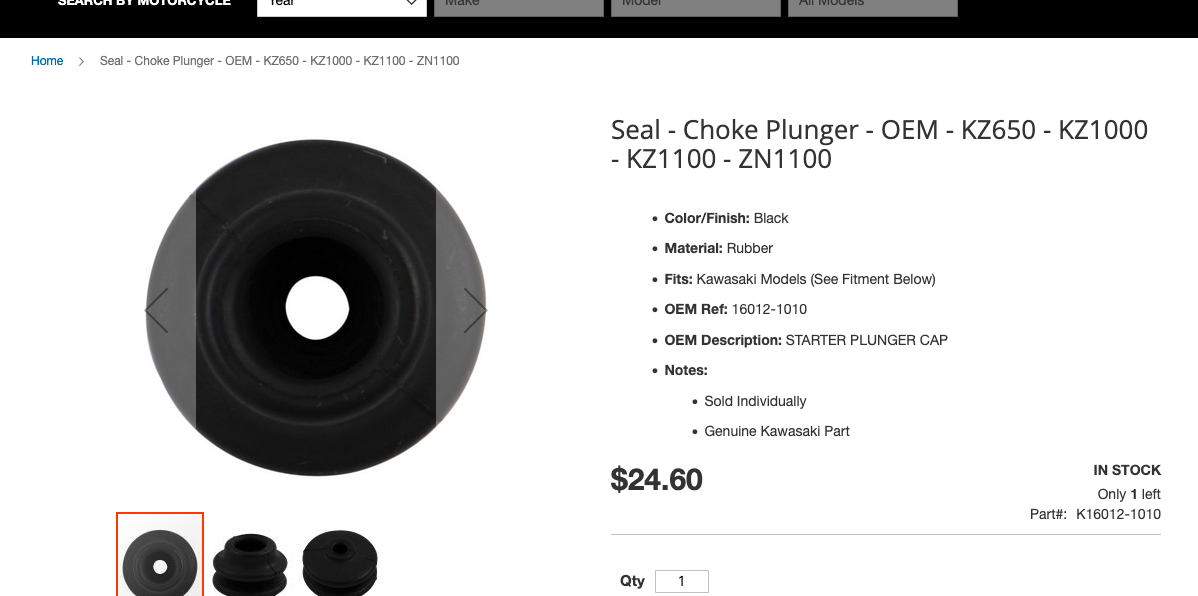

Can I ask a dumb question? So how do i fix this? Take the carbs off ( i hear its a nightmare with the airbox) and then what? Where do I get the seals?
Update: After I posted the above, I did some research. I see its these things from Z1. Guess I have to take the carbs off to put them on?
Note that the carbs were rebuilt not too long ago. Could it be something else?
Last edit: 01 May 2025 06:17 by AlexRocco.
- Posts: 6479
- Thanks: 4081
Re: Dirty Air Filter = black plugs?
01 May 2025 06:34
Those look like the "outer dust seals" the actual plunger seals are not straightforward to replace but member Zed1015 offers a referb service on these (many members have used and praise the service offered) You could reach out to him through the PM function

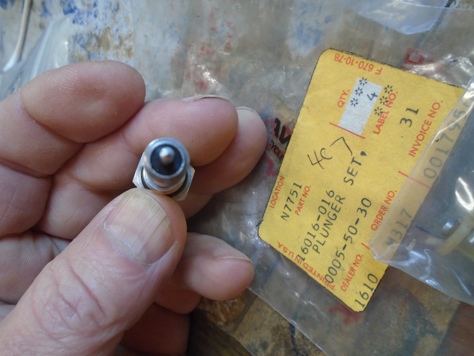

It's the seals in the end of the plunger that closes off the fuel supply when the choke is off that causes rich running issues.
Once they start leaking you are effectively running on anything from partial to full choke depending on the severity.
You can't buy the seals because the the plungers were never supposed to be a servicable part but i developed a way of replacing them with fuel resistant Viton without damaging the original swaged retaining edge.
You would need to remove the plungers and send them to me for repair.
Email me at zed.1015@yahoo.co.uk for more info.
The pic below is before on the left and after with new seal on the right.
Rob.
