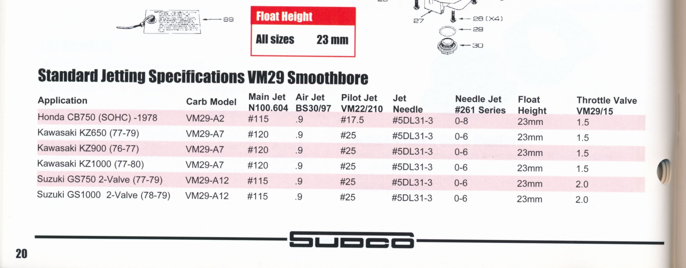

Below is the VM29 application chart to check which machine your carbs were original spec'd for.
The fuel level needs to be set to the correct 23mm fuel height at the main jet so take the measurement at the mid point and forget about the high and low readings fore and aft due to the racks angle .
The pilot jet should be 17.5 ( If your VM's are the correct spec for the Honda).
