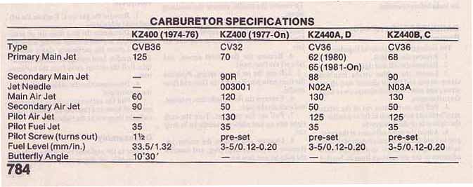

Not sure if this will help any but here are some specs for the CV 36 carbs that came stock on the 80 440 LTD (A1). Note it lists both mm and inches for float height, as well as well as other internal parts.
