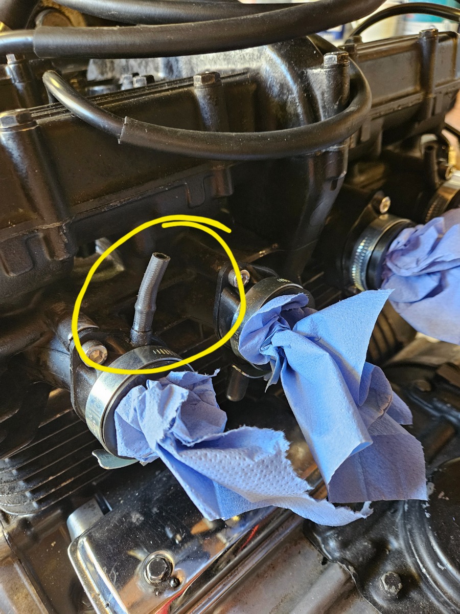

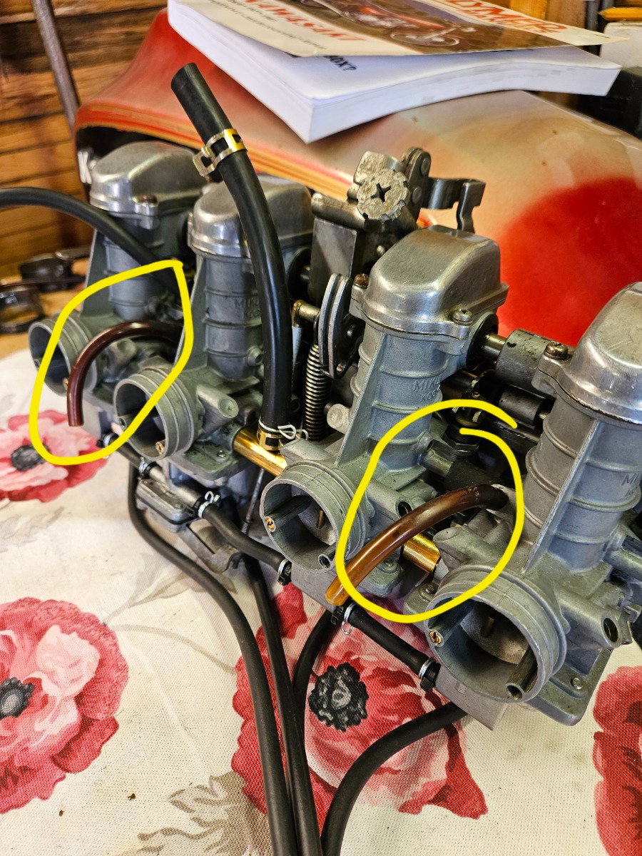

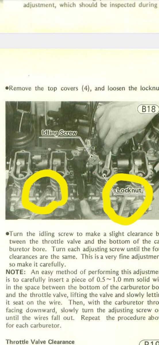

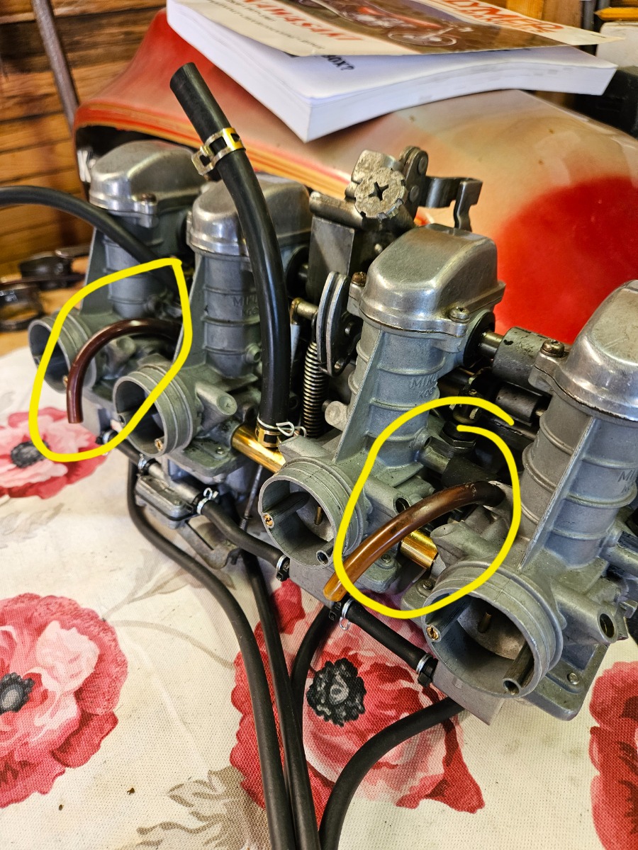

06 Apr 2025 07:45 - 06 Apr 2025 07:48The circled spigots in yellow on pictures 1,2 & 4 are vacuum sync ports which must be capped in normal running.Deon post=911015 userid=65219
The two circled in yellow on pic 3 (manual pic) are vents and should be left open to air as they allow air to escape from the bowls as they fill with fuel.
The two circled yellow in pic 5 are the vents shown in the manual picture.
The vacuum tap spigot is this black one.
