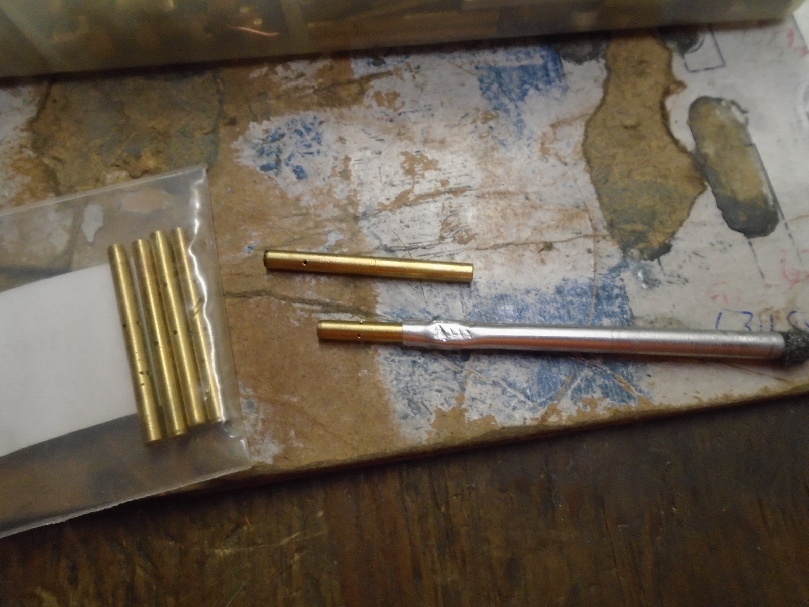

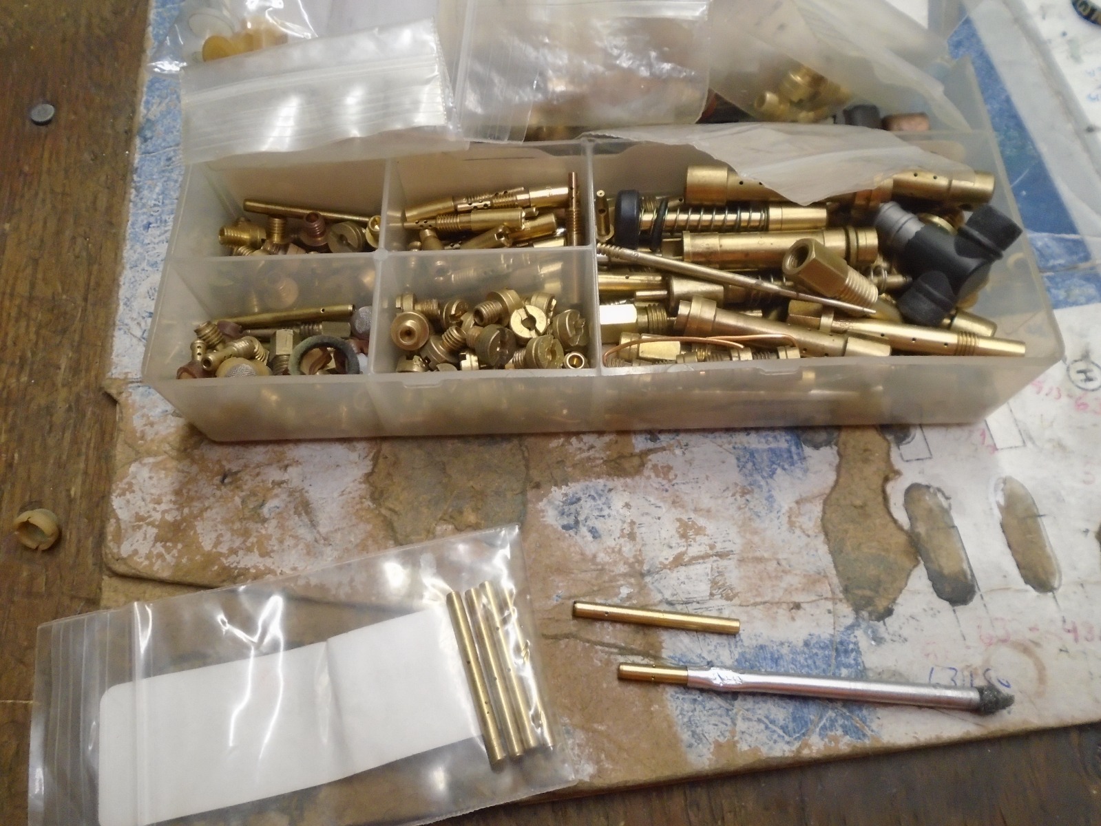

Some additional procedures i always perform on the VM carbs. Like Ed mentioned, you can pull plunger and shoot Carb Cleaner, using provided straw, to shoot down that plunger cast hole. But i always just pull the brass pick-up tube. Why?? Because the P/U tube is a tube with a flat slug swagged on the lowest point, then drilled with an approx #75 twist bit thru the center. What can happen is crud will collect around that "drilled slug" inside the tube. You won't see it from the outside but chemicals will soften up the gunk but chunks can remain lodged in there causing fits later of starting. A sort of capillary effect of old fuel.

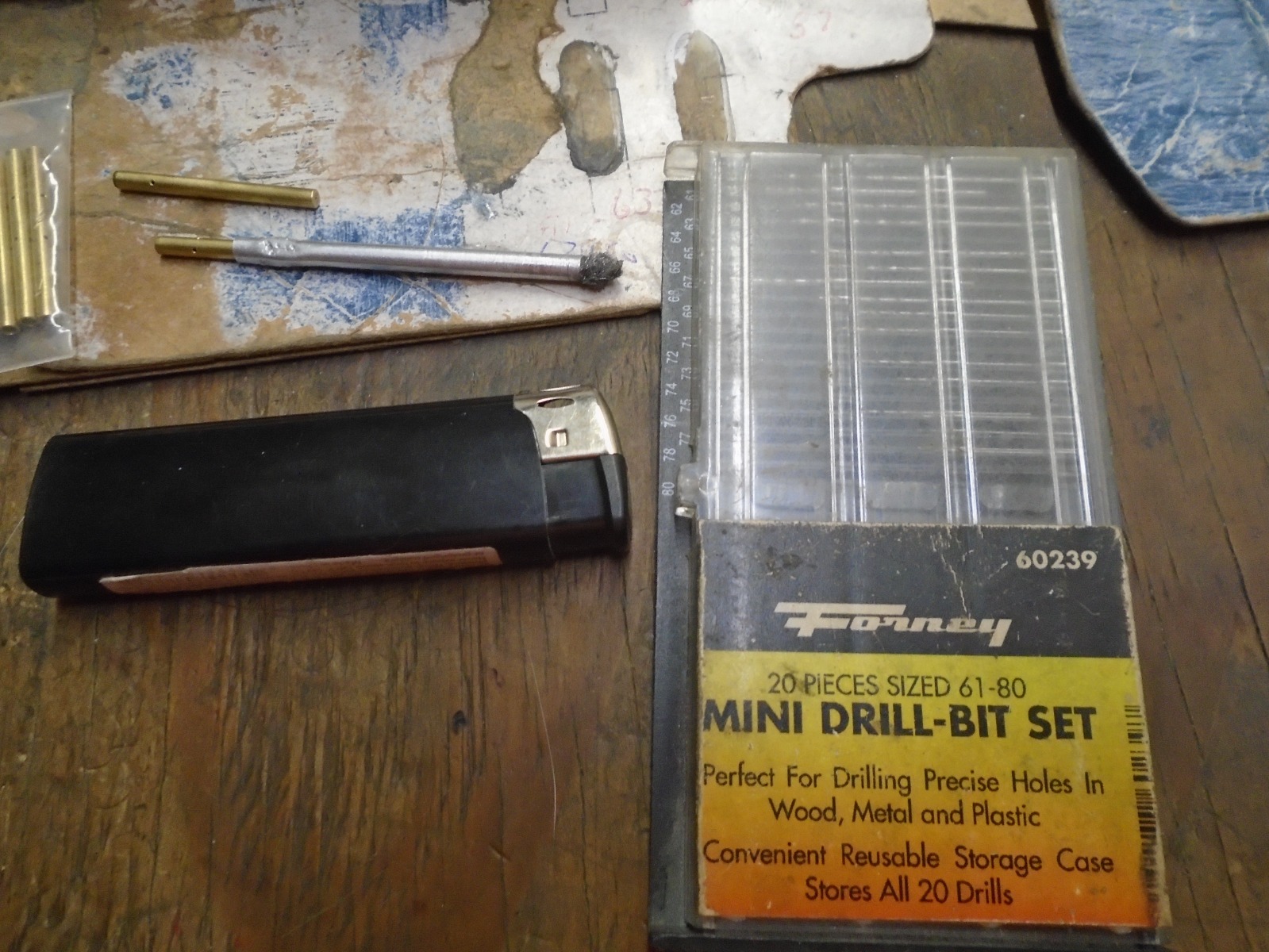

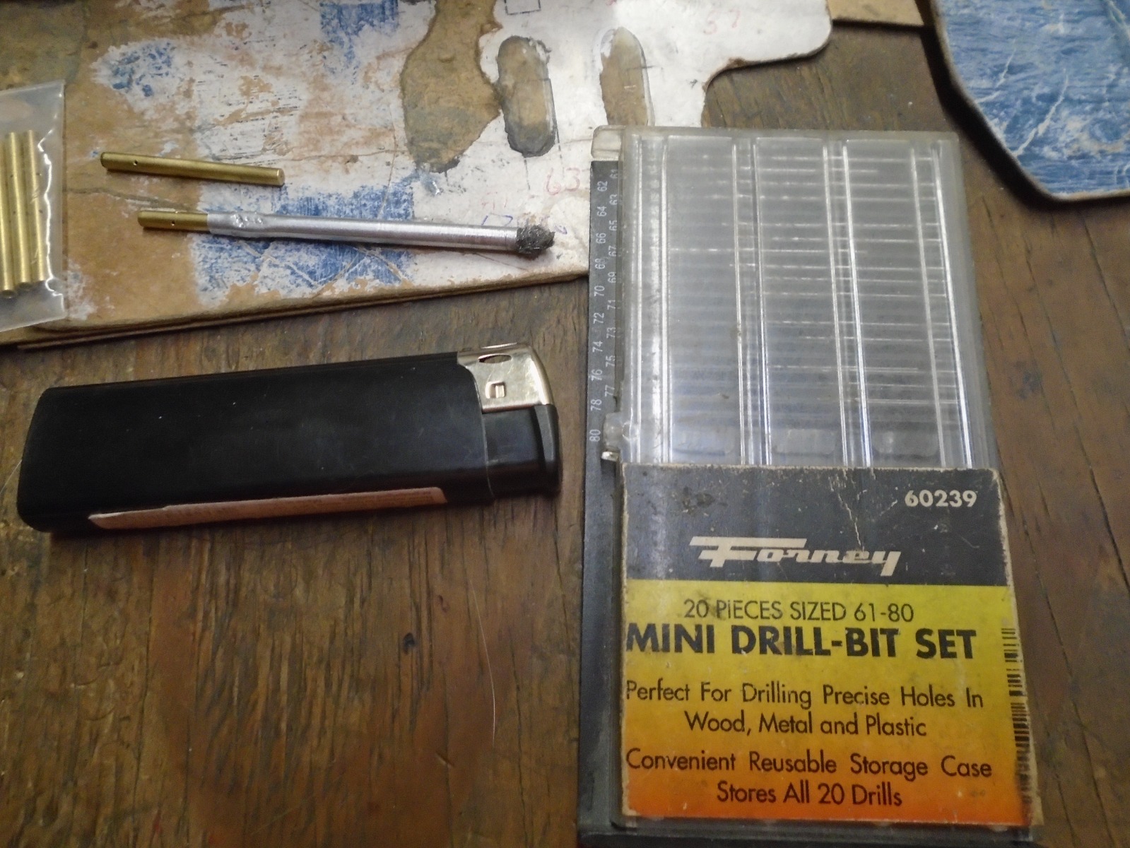

Or just grab an old lighter and remove the spring and use it. I like the little twist bits because it uniformly shapes/cleans the little hole. I use an 1/8" piece of aluminum tubing to pull. You don't want to just ham-fist grab the tube with toothed pliers, sleeve it first with tubing. Then twist and pull straight out. Might note/measure original assembled protrusion length between casting and end of tube before you pull it/them. I use a rope of 000 steel wool to internally clean the tube. All this may be overkill but you'll be assured it's clean.. Reassembly use a "Plastic" tool to squarely compression set tube back in place. Not too hard pounding or you'll split the tube and that slug will fall out. Have Fun!!

Thank you to everyone. Clay you have a great idea on how to carefully remove and clean this tube. I will have to do some scouting around in order to find that one eighth aluminum tubing. I am not sure what it is that you do with the lighter and I am trying to imagine a way that I can create a soft plastic tool to protect the tube when reinstalling it.
