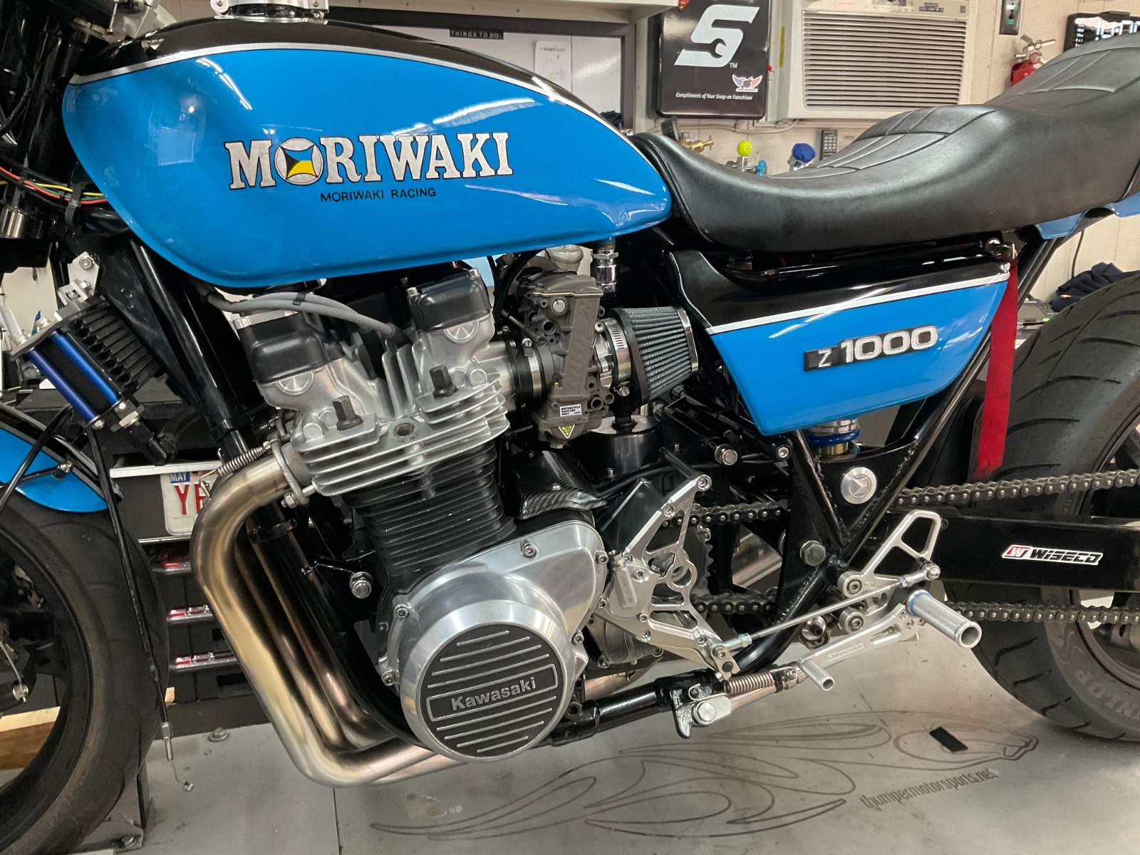

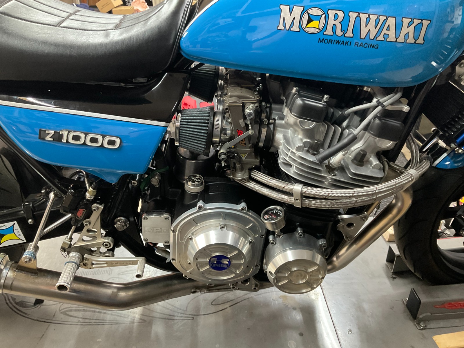

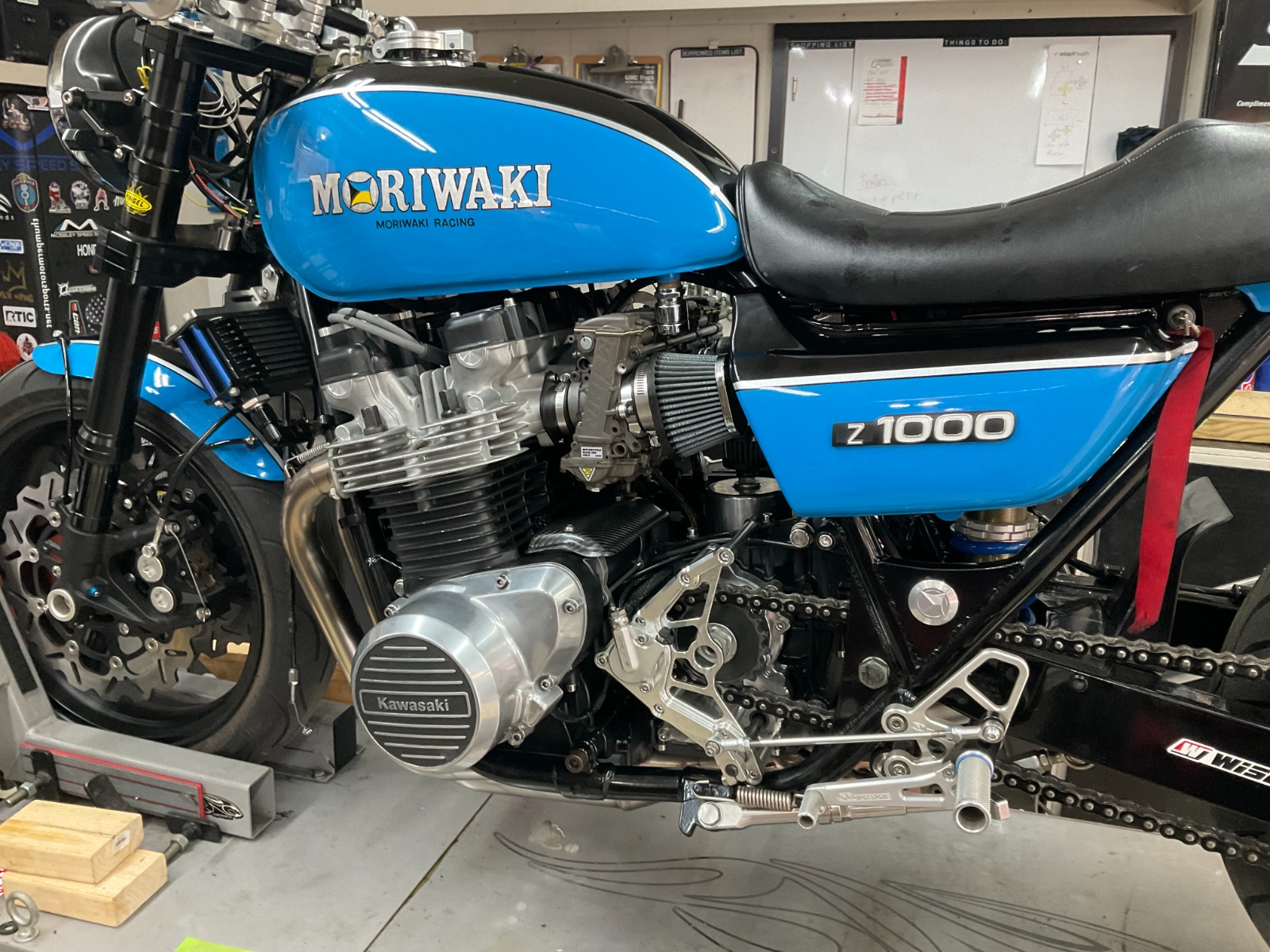

Hey doc, totally understand the wows of carb tuning, Currently Just about done with tunning the rs 34s which will stay on this project, it took some figuring out the overlapping circuits and have them dialed in 90% so should be finishing them up this spring, I do like the look of these FCR carbs and have been doing research as to tuning them . As mentioned, they are going to be for a J replica I hope to start in about a year from now , might mount them on this bike at the end of the season to get some practice and would like to see how close they are to being turned, I did mount them the other day just to see how they looked and the fit with the petcock just to get an Idea .

Sorry about that Guy, I had taken updated pics and did not follow through with the plan, at work and had some time so Just sent you some pics hope they came through I if they did not come through let me know, Thanks again for the KZ rider members for giving me the motivation not to give up on this project, Cheers
