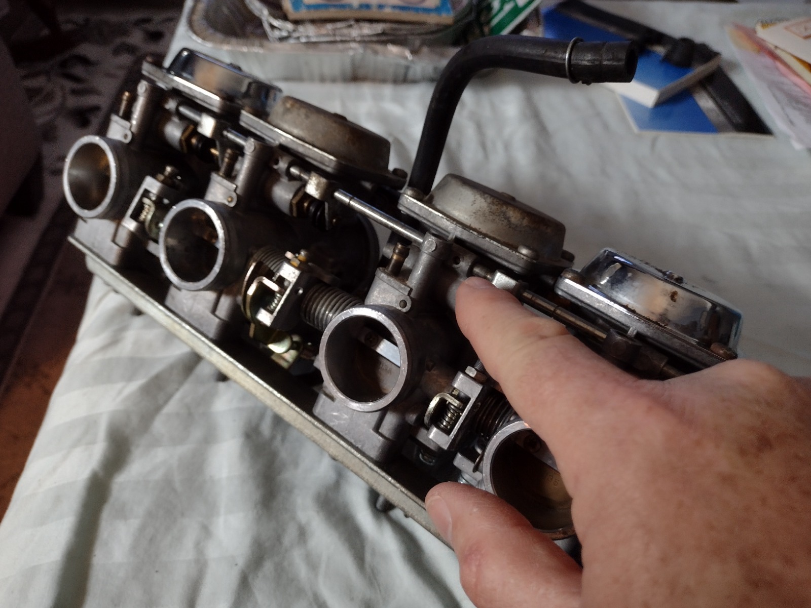

Hi all, the springs (2) that activate the check balls that engage the choke rod detents are no longer available from Kawasaki. Does anyone have an alternative or a couple of extras laying around? Mine disappeared, I have the check balls. Kawasaki P/N 92801-1260, Mikuni BS32 carbs. Any help is appreciated. Thanks!

McMaster-Carr has some tiny springs

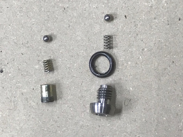

Another option is Amazon, I got the below for my damper adjusters (3mm balls and 3x5mm springs) in packs of 10 for around $7 each. They have other sizes if somebody can give you the dimensions of what you need

Thanks guys...I read somewhere that they're 3 mm x 7.8 mm but can't remember where I saw that. I'm getting old...

27 Feb 2025 15:53Measure the holeThanks guys...I read somewhere that they're 3 mm x 7.8 mm but can't remember where I saw that. I'm getting old...

Hi Ed, yeah looks like 11/16" long x 1/8" in diameter (17.68 mm x 3.18 mm). Hopefully I can find something that works. Thanks!
