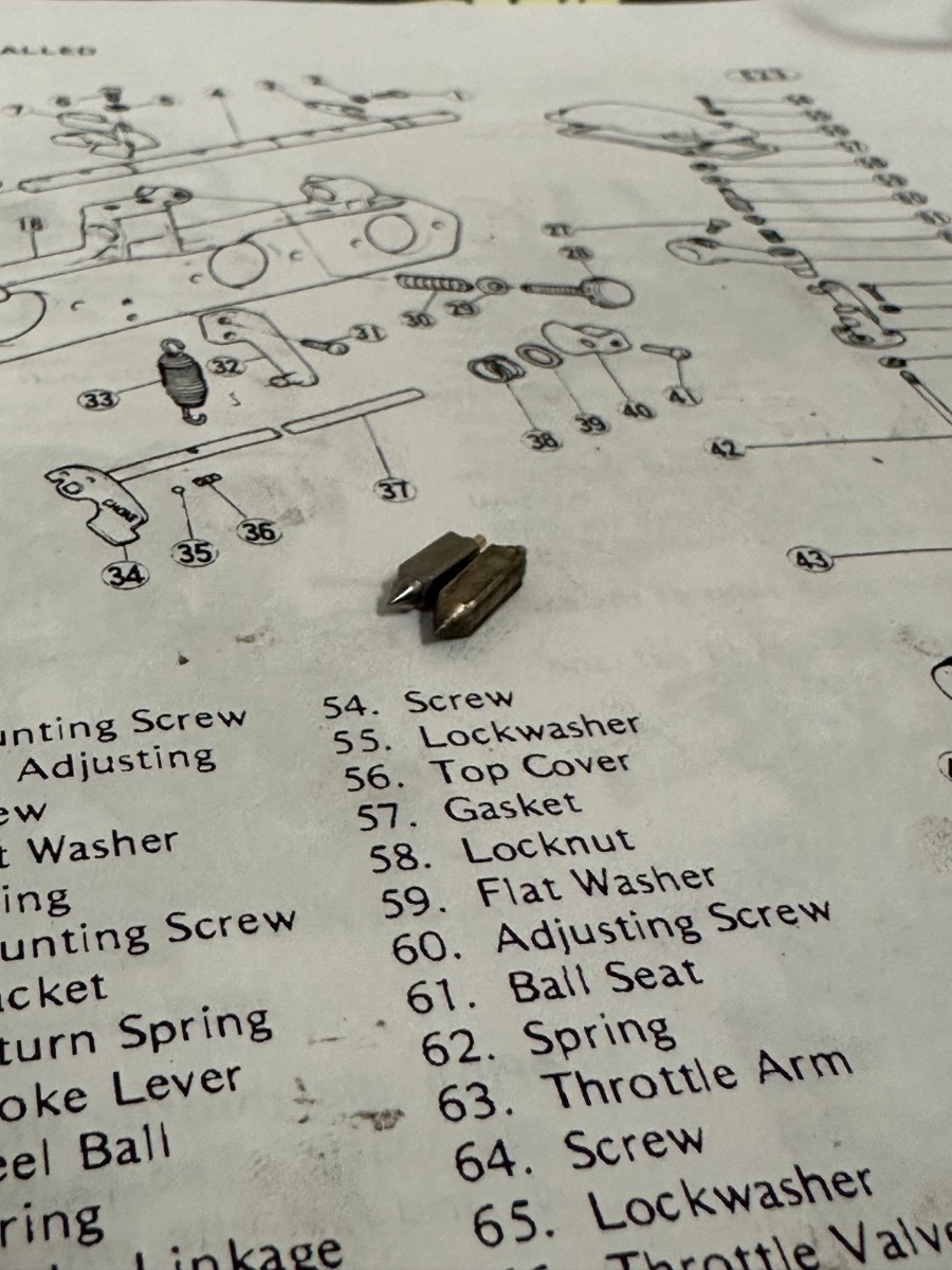

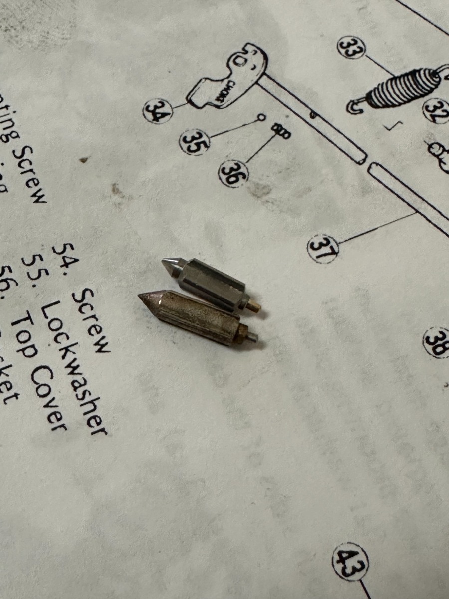

Can you post photos of both float valves side by side?

Re: Rebuild kit has wrong float valve needle? Do I have a different carb?
24 Feb 2025 15:29Please Log in or Create an account to join the conversation.

24 Feb 2025 18:08 - 24 Feb 2025 18:08What about the seat? The seat and needle are a set.For sure
With both needles fully inserted into their respective seat, how does the height compare then?

24 Feb 2025 20:13
Ok yeah so I feel really dumb, its just fine. I put an original one in because I managed to lose one of the new ones, and I was going to use the original because it still felt ok (This bike is rough and my goal is only to have it run in general). Looks like ill be ordering a new one regardless. Anyways, thank you for your help!
