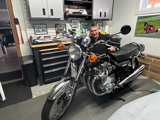

It look like this post is in the wrong section ! It' now belong to the engine section
You guy's were right. I have # 3 & 4 exhaust valve that are out of spec at less that .0015'' / .038 mm and # 2 intake at .008'' / .203 mm.
The others are withing spec (as per Kawa spec revision) .002'' to .006 '' / .051 mm to .152 mm.
I am surprised ! The engine was recently overhauled according to the $10,000 invoice provided by the previous owner.
So, I just ordered the valve tool and a set of shims. Hopefully this will fix it !
Anyway ... It allowed me to update my photo....48 years later

I fixed your pics, next time click "insert all" before posting and don't set as private
