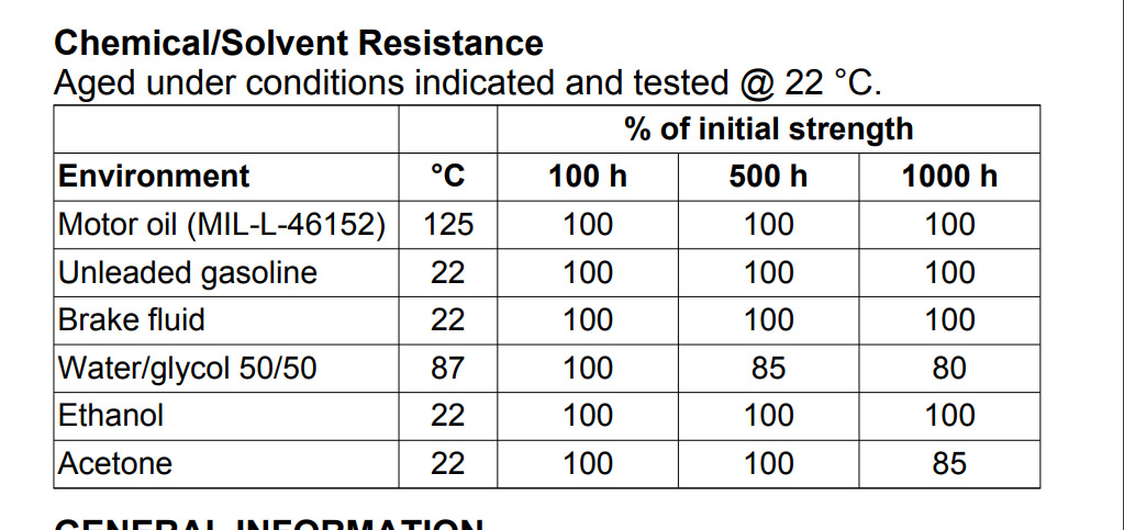

Some flavor of green Loctite is definitely the right answer. The 609 mentioned by Cra-z1 looks like a very good fit. These products are designed to permanently bond close fitting metal parts together, and are specified for use in the presence of gasoline and oil and other solvents. The datasheet has a nice table that shows the resistance to gasoline and ethanol.
datasheets.tdx.henkel.com/LOCTITE-609-en_GL.pdf
