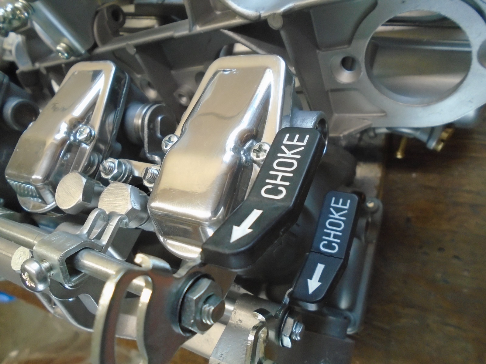

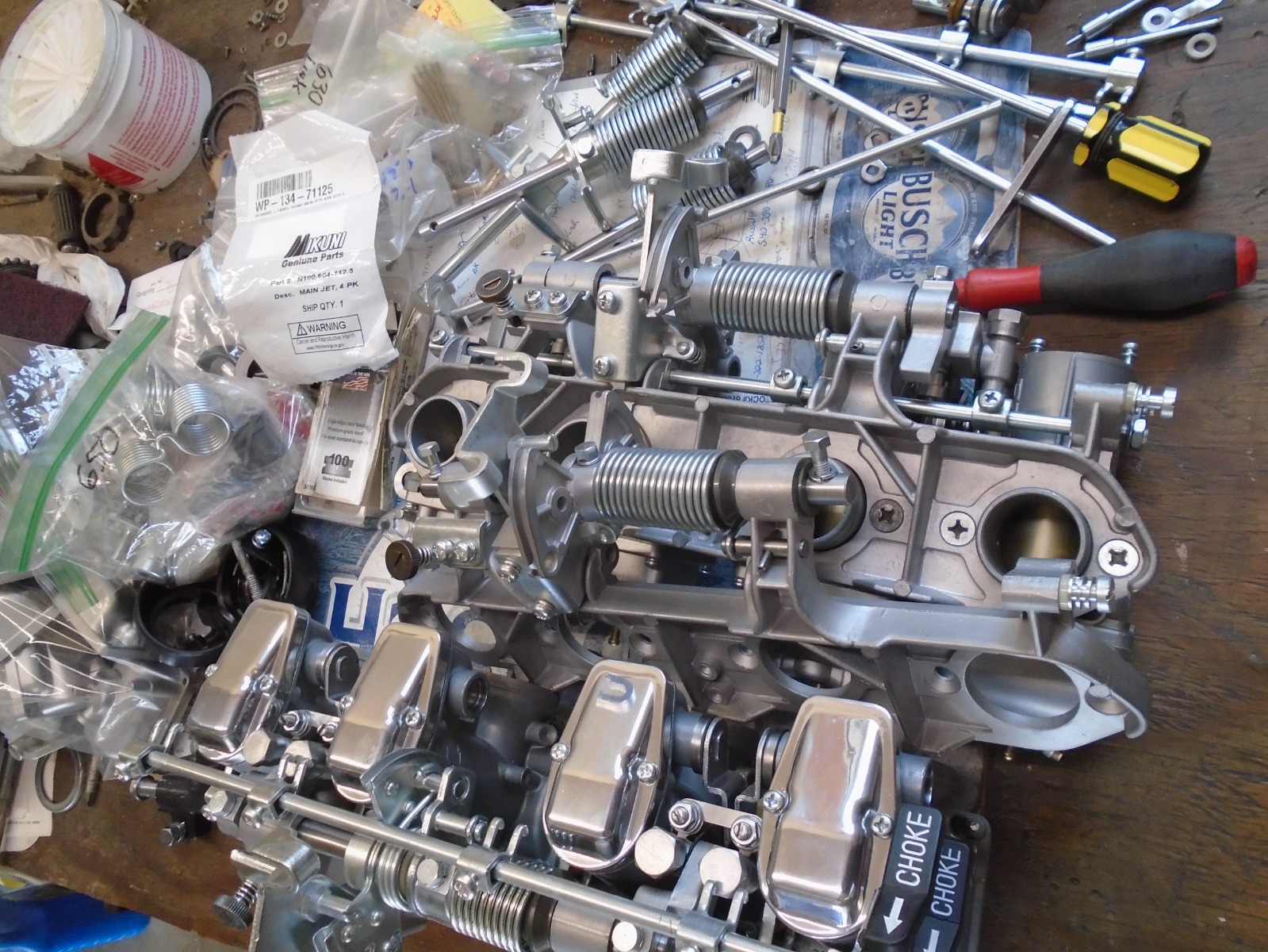

I remember a Gent that used to sell these choke lifters but can't seem to find that person. I've a gaggle of the late 1974-1975 carbs for the Z1's with a batch good metal choke backers eligible for whatever he did to recoat with plastic. That's it..

That's the guy McDroid!! He advertised them on this forum a while back he also had them listed on ebay at about the same time. He's in the US...i believe.

Your carbs look great by the way.
