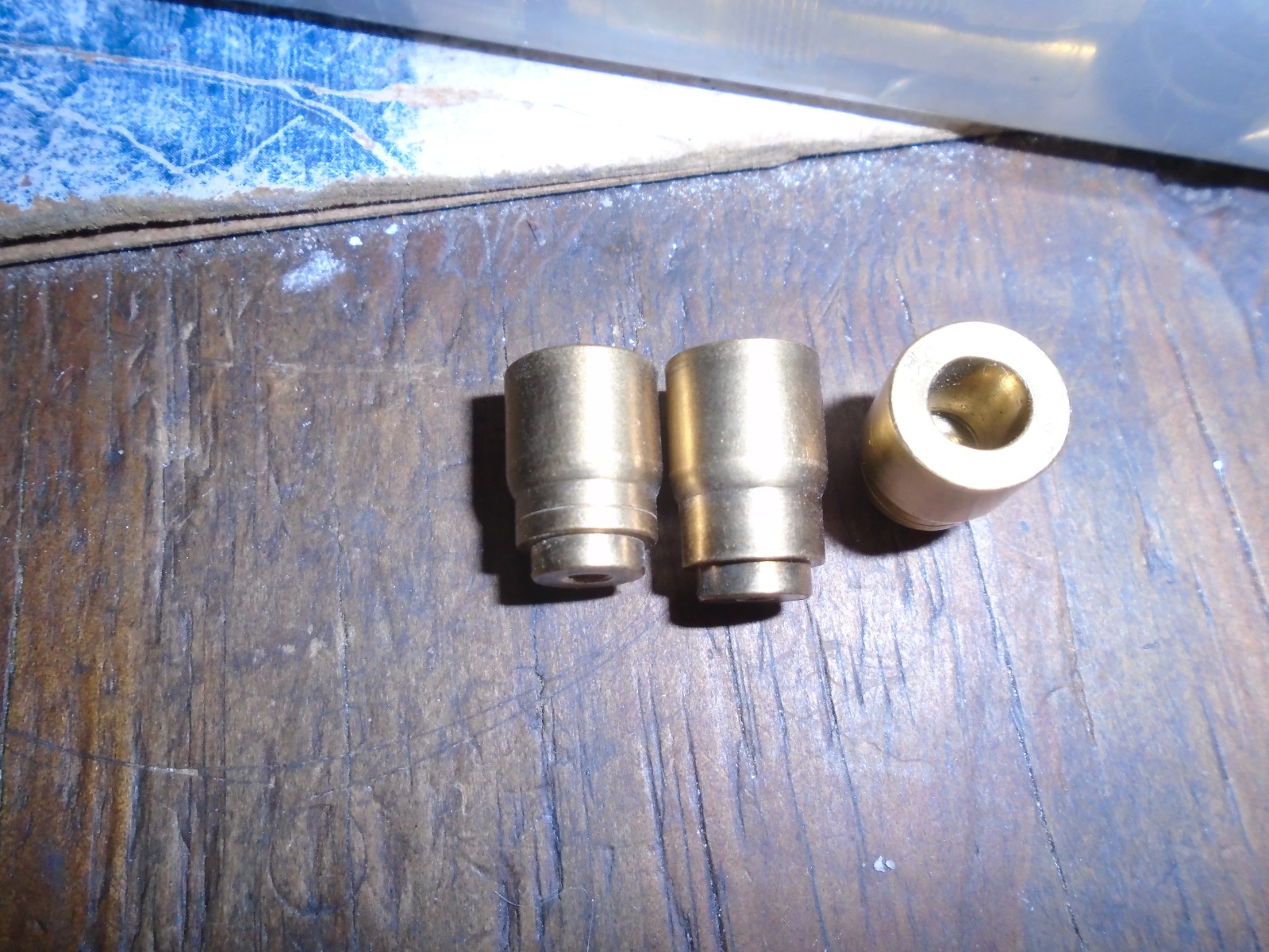

Just some considerations Bozo. Yes as mentioned, correct cap ventilation of course. When You say surge, under what conditions? Is it at an even slight throttle, like going on fairly flat terrain and feels like it is "hunting"? Or WOT and missing out and stumbling? You mentioned something about those Float needle seats or You call them Inlet seats. Actually introduction of a fuel pump will require Smaller inlet seats, not bigger. And you'll find changing those seats doubtfully would be required. And if so, gotta know how to do it, they are pressed-in on those CVK Keihin's. And no replacements that i'm aware of off the shelf. I pull them to get behind and remove crud but a special technique is used. A couple versions shown, note length differences.
