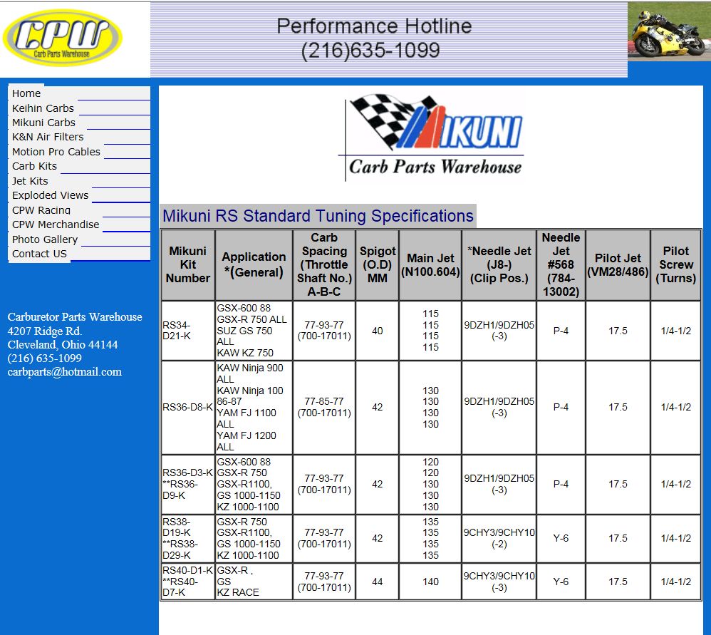

I think that is as large as I would go on a stock engine. They may be a bit too big. The answer to your jetting question depends on how they are jetted now.

thanks for the reply texaskz the 34's have 125 mains. and 17.5 pilots .those are what came in the carbs

That "out of the box" jetting is a good place to start. Every engine is going to be slightly different depending on compression, ignition, etc.
With a stock 1000 that seems about right. I ran RS34's on my 831cc 650 a few Summers ago, 20 pilots and 122.5 mains with pipe/pods. The head on that engine flows more than a stock GPZ1100 and makes about 85-90 HP.
Do a high speed plug chop to set the mains, check plug color, etc. I would use a ColorTune kit to set idle if you have access to one.
You can do a search on here as well for recommendations on those carbs.

We put a set of RS 34 D21 K carbs on the 77' KZ 1000 LTD. The place wanted to know if the motor was stock, points or electronic ignition, air box or pods, stock exhaust or 4 into 1 exhaust?
Installed the RS 34's and it ran great right out of the box. Stock motor, Dyna ignition, K&N pods and a Delkevik 4 into 1 exhaust. They came with spare jets bigger and smaller than the installed jets but they are still in the box.
We got RS 36's for the 80' Suzuki GS 1100E from the same place with the same results. The RS carbs really woke up both bikes.
