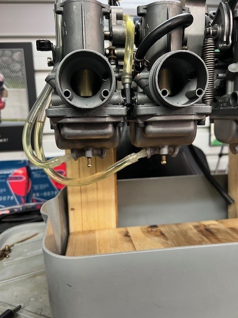

Float adjustment completed !
I finally re-installed the original Mikuni float valves since they seem to be in good condition. I corrected what could have been the cause for the overflow or the random results of the clear tube tests.
1) The tangs had some irregularities caused by the previous adjustments. I boffed them with a dremel and then polished them.
2) I cleaned the seats with a Q-tip and Mother polish using a drill. Then, cleaned with carburetor cleaner.
3) I reduced the movement of the floats by adjusting the stoppers.
4) Set up the floats height at 25 mm (with gasket).
5) The clear tube level check was withing specs: app. 1/8'' below the edge of the carbs body. (after minor ajutments)
My next steps will be the carbs syncronisation using my new Carbtune Pro and install the K&N pods.
I did not change the 115 main jet at this point. I will see how it's running and check the plugs.
