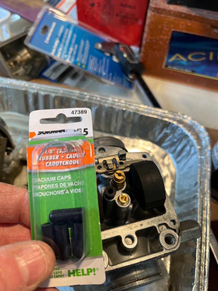

So I started the process of disassembling, cleaning, and rebuilding my carbs off my 81 LTD. During this process I lost one of those little brown pilot jet plugs that are on the CV34’s. What the hell do I do now? They are needed for correct vacuum, yes? Calling out to the community for an assist. Thanks for reading.

I used the attached before I was able to score some used plugs.
I “chucked” these over a hex bit and ground them to size with a file. They never fell out and you should be able to use the other as a guide for sizing.
Good luck with it.
Good luck with it.
