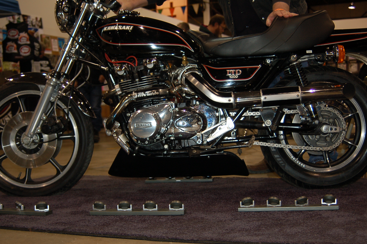

Here is my 78 LTD

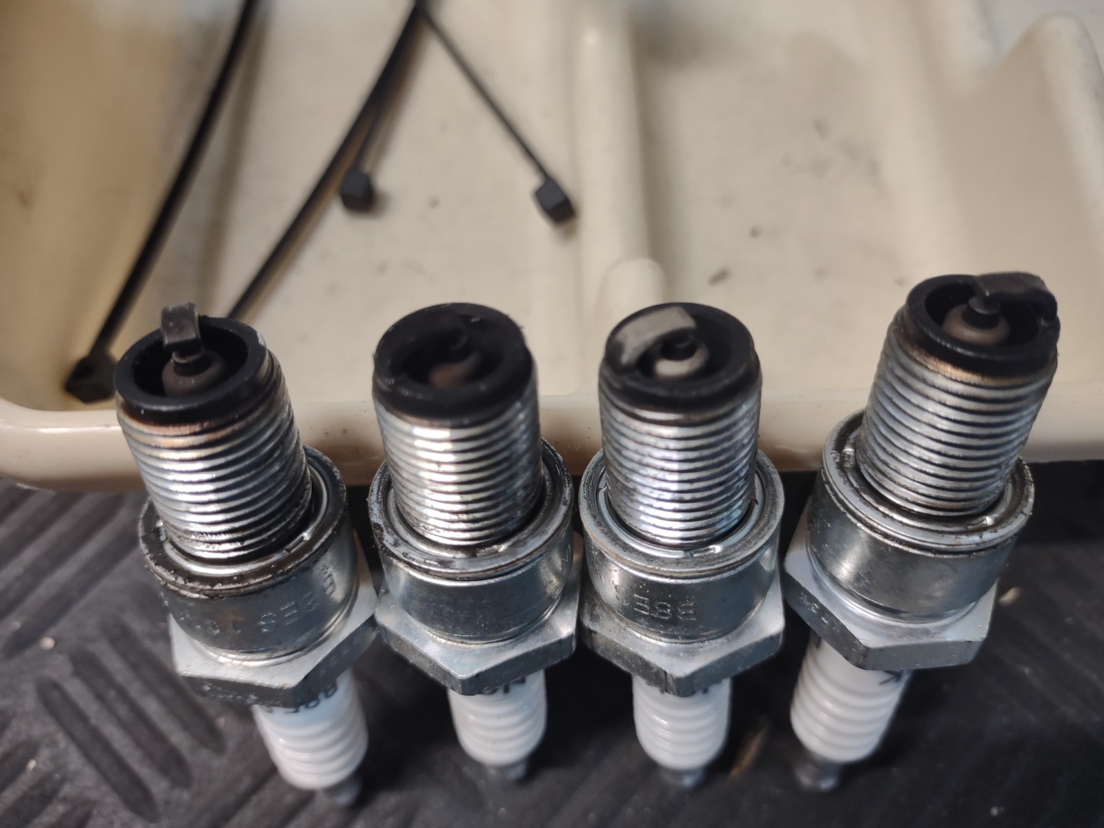

I want to thank everyone for their help. I’m trying to learn this as I go. I took the carbs apart and cleaned them using plenty of carb cleaner and an air hose, then put everything back together. Changed the jets to 120 main and 17.5 pilot fuel screw at 1 1/4 out. Bike ran great (maybe even a little stronger than before) under heavy throttle, however a little “boggy” on take off and at cruising. If I snap the throttle from idle it bogs, if I roll on the throttle it is fine. Came home and took the plugs out to see what I could. To me 1 and 4 look fine, but 2 might be a tad rich and 3 looks lean. Where did I go wrong lol. Before this all looked lean.

30 Jan 2025 11:14 - 30 Jan 2025 12:11I am guessing pods and pipe (you never stated) What were the original jets?Changed the jets to 120 main and 17.5 pilot fuel screw at 1 1/4 out. Bike ran great (maybe even a little stronger than before) under heavy throttle, however a little “boggy” on take off and at cruising.
I never recommend making multiples jet changes in one go because it makes it more difficult to diagnose what was wrong in the first place.
I suggest going back to your original jetting pre clean out as it just may have needed a spray out to clean the pilot circuit. Gas tarnish can build up rapidly especially if the bike has been sitting in unheated storage where temperature fluctuations can draw moisture (water)
If you have access to a Color Tune kit that is the best way to set the pilot circuit, especially for non stock jetting. You can also set by ear but its a little more difficult to master. Its either a pilot jet or air/fuel screw setting issue, it is not a needle height issue. If you still have black plugs afterwards it may be a choke plunger seal issue.

Yes, pods and Kerker W/baffle in place, sorry about that. Was 15 pilot and 115 main. All plugs seemed a little lean at that point. First cleaning the bike still sputtered at minimal throttle, so I took carbs off cleaned them again and changed jets. I am going to check into this color tune kit you speak of. Shouldn’t all the air/fuel screws be set exactly the same?

30 Jan 2025 14:46 - 30 Jan 2025 14:47
The airscrew settings will be different for each cylinder as they wear differently.

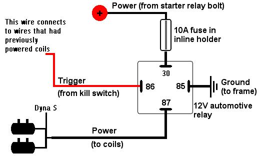

However, as the two cylinders which are sooted are 2&3 and they both run off the same coil a low voltage feed to that coil would cause your symptoms. Check the voltage at both coils are at the very least
11. 5 volts. If coil feeding cylinders 2&3 is less then resolve that first by cleaning all the connections, retesting, etc. Alternatively consider fitting the wired gearge mod which supplies full battery volts to the coils without the issues old wiring looms and switches can cause.
