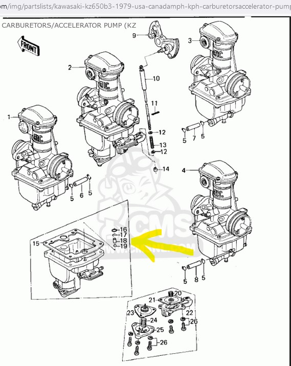

I just stripped down the carb assembly ready for vapour blasting and I found that in one of the float bowls there was a ball and weight came out. I checked the other 3 and they were secured by a very tiny spring. I don't know what it is called or what it is for. Looking at parts diagrams it does not even come up as a part. These items are not in any parts list I have found. Any ideas appreciated, TIA

That ball, weight, and c clip are for the accelerator pump feed. Each float bowl should have these parts or the accelerator pump won't work.

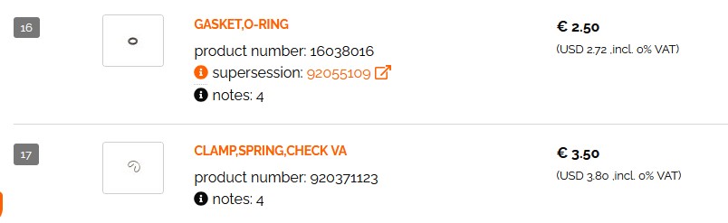

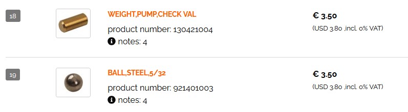

20 Oct 2024 17:54 - 20 Oct 2024 17:57I just stripped down the carb assembly ready for vapour blasting and I found that in one of the float bowls there was a ball and weight came out. I checked the other 3 and they were secured by a very tiny spring. I don't know what it is called or what it is for. Looking at parts diagrams it does not even come up as a part. These items are not in any parts list I have found. Any ideas appreciated, TIA
Took about 2 minutes to locate... but it looks like only the O ring is still available to order, so don't loose those parts!
