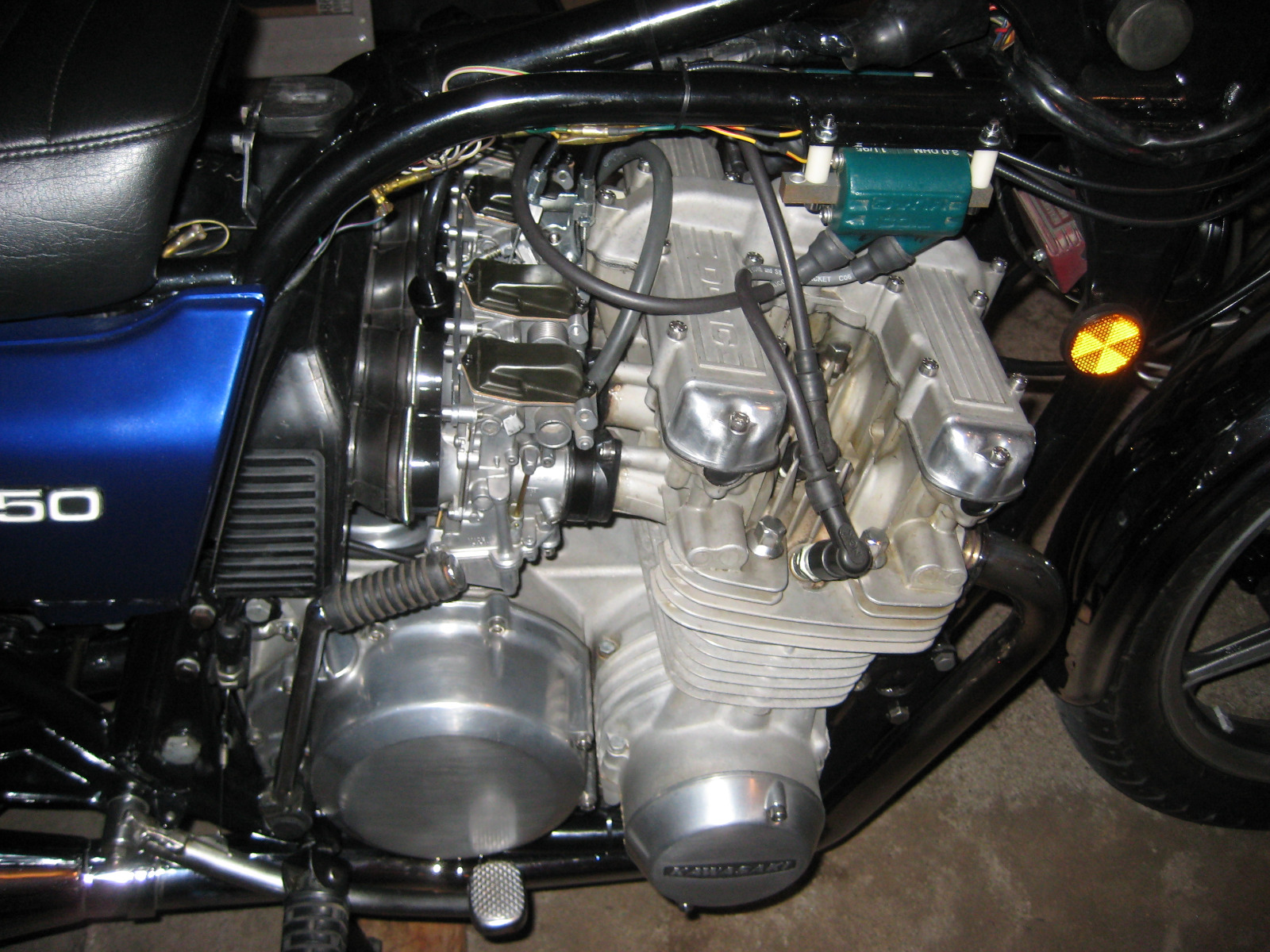

I have run them but the 33 mm version, no issues on my 831cc engine. I did have to respace the bodies on mine and put the cable pull in the center. These carbs come with the cable pull toward the right side so they foul on the bottom of the tank if you don't modify the mount bracket. You also have to watch out for worn slides as they tend to give huge vacuum leaks if there are any scores on them.
Not sure what you have done to your engine besides the bore kit, but you need to know that a flat slide is equal to running a much bigger round slide just from increased CFM. My engine has a big valve pro ported head with big cams, so it can take any carb I throw at it.

I have found that they require quite large pilot jets to run correctly so on my hot rod engine they guzzle the gas. I think I may get around 28 MPG which is terrible but I think that has to do with the rest of the build. The float bowls are slanted so setting up the correct fuel level is quite a chore.
Once dialed in there are no issues, very good throttle response, basically race carbs.
I do have a set of RS34 flat slides to compare with and they work slightly better, maybe because they are new with hardly any wear?
I also have a set of CVK34's on my 750 engine and they seem to perform just as good but that engine is a stock Spectre, basically a GPZ top end with detuned cams (slightly less lift and duration) so its quite a bit weaker than the 831.
The CVK's are the best responding carbs other than the flat slides, way better than round slide VM's excepting the smooth bore series (race carbs) Seeing that your engine is mostly stock I don't think your going to gain much by switching to the 29's over the CVK32's other than the racy look of the GSXR carbs.
