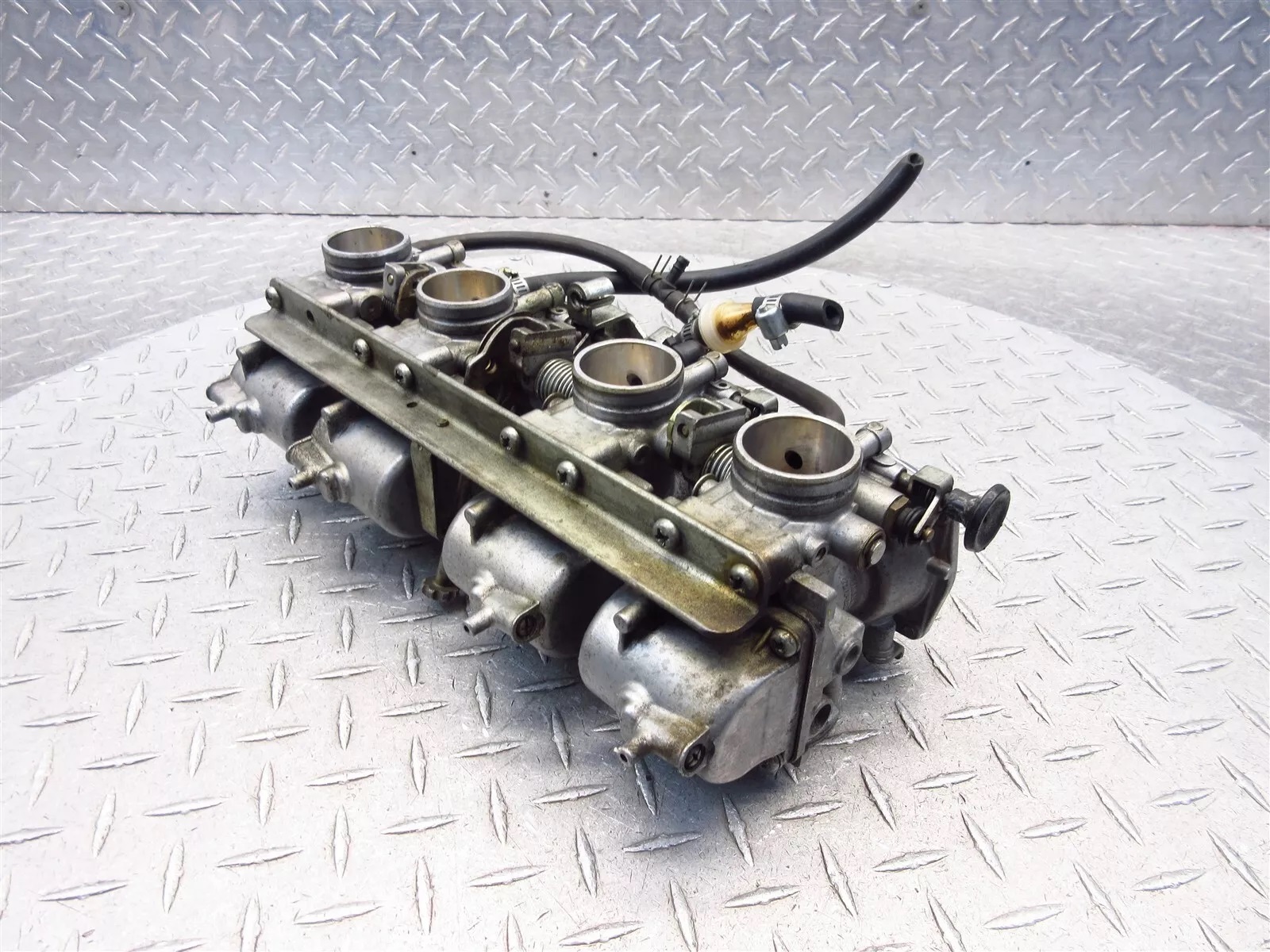

Hey Steve, those cop bike carbs are simple one cable, not two.

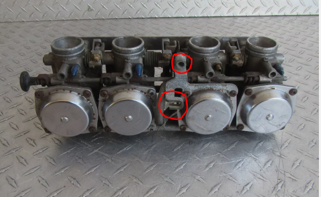

22 Sep 2024 21:02They have two cables. One pull the other return.Hey Steve, those cop bike carbs are simple one cable, not two.

The way they're fitted the cables go on a sharp angle to the pullies. Tried other ways but no soap.

You would need both the bracket and the pulley, which attaches to one of the throttle shafts. It wouldn't surprise me if the throttle shaft is different too.
