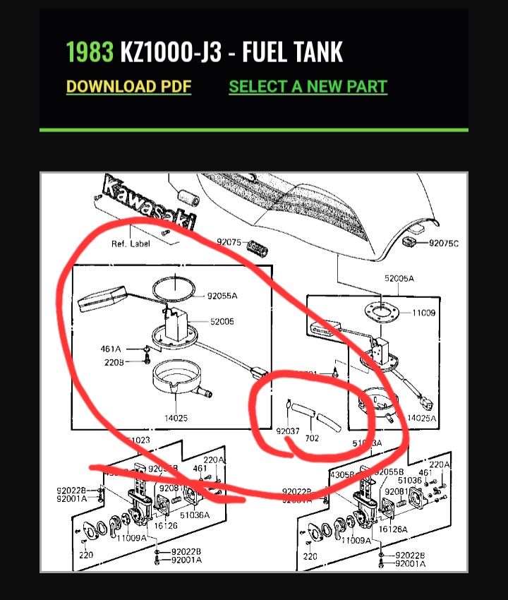

Thanks. On the J3, can you tell me what the vent hose connects too?

There is no "Vent hose" on a J3.
I think the hose you are talking about is on the underside of the tank on the rh side? If so that is the drain hose to stop fuel leaking onto the hot engine should the gasket fail on the fuel level sender unit.
The tank vents though a vent hole in the fuel tank cap.
It allows air into the tank to stop vacuum fuel starvation as the fuel level drops from the engine running and allows air/fumes to escape caused by heat expansion of the tank contents.
You'll need to dismantle the cap and ensure all the vent channels/holes are fully clear. Whilst apart you should lubricate all the moving parts.
Your also over filling the tank by filling to the bottom of the filler sleeve. If the bike were on the sidestand or leaning during cornering then your asking the cap seal to do all the work of stopping leakage. It's not designed to do that it's more of a splash guard when fuel is sloshing around during riding.

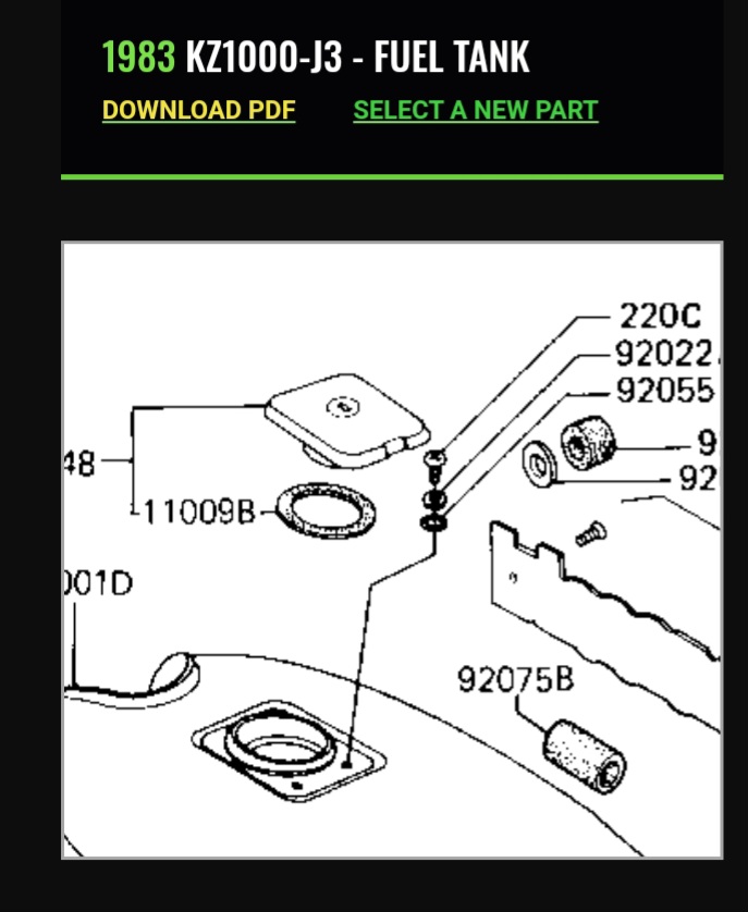

J1-3 just has 2 screws holding the entire cap on, they are holding the lower hinge plate to the tank. Undo those two and the entire cat and hinge comes off in one piece. Access them when the cap is open. It'll be so much easier with the entire cap off. Those screws are very short so shouldn't be too difficult to undo.

Haven't seen any diagrams on the cap internals. Due to the sealant on the two screws fastening it to the tank I am prepared to just protect the tank and take the cap apart and clean it on the tank. Once I take out the two screws what should I expect to see? I believe the vent is at the bottom of the keyhole in the cap itself which i need to get to. I've attached a couple of pics. Thanks

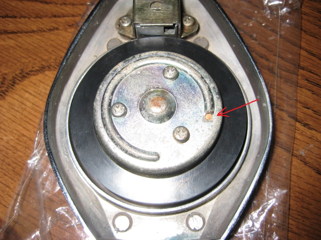

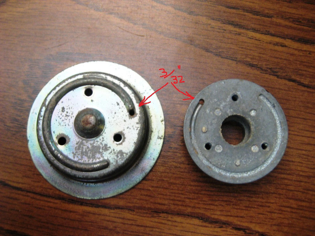

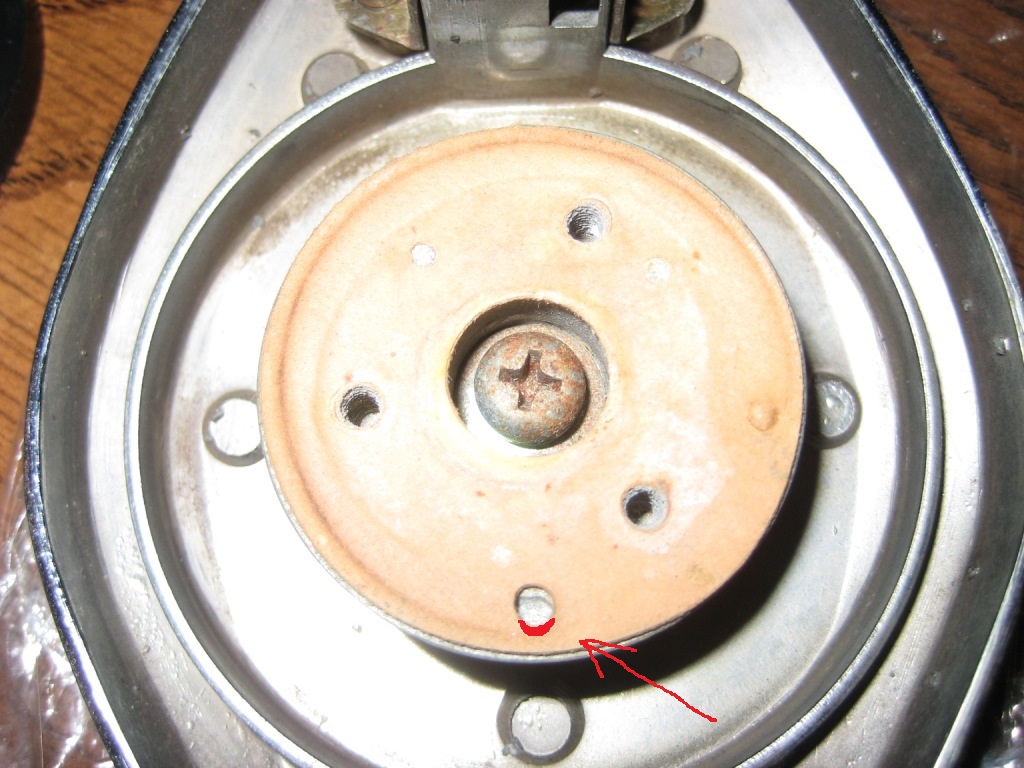

Not sure if its the same thing but on a normal KZ gas cap you can increase the "vent" hole size to help it vent easier. I use to get a lot of hissing on Summer rides with a hot rod motor until I modified the internals.
The vent hole is small and can sometimes be clogged by tiny spiders! Shown is a KZ650 cap (same as a KZ900 cap)
Its just a cork or paper? gasket inside and its non replaceable so you need to take care you don't mess it up. I guess you could replace it with something else but never tried. Sometimes the gasket is even miss matched over the hole blocking it a little.
One of those parts Kawasaki never intended people to mess with
It helped with the hissing, way less hissing with bigger hole.
I do this to all my gas caps.

28 Sep 2024 18:25
Opened the cap up. And cleaned the vent hole that's integral to the silver cap. Blew compressed air through it and could feel it coming through the key hole which is good. Question there is a large centre spring that compresses against a white plastic washer in the metal cap housing that was screwed down on the silver cap. On the other side of this white washer there is a black rubber gasket that is groved on one side that fits into the metal housing. I placed the grooved part of the gasket against the white washer as it seemed to sit better in the housing. I could not recall how it looked when I opened it. Does this sound right or does the flat side of the black gasket sit against the washer?
