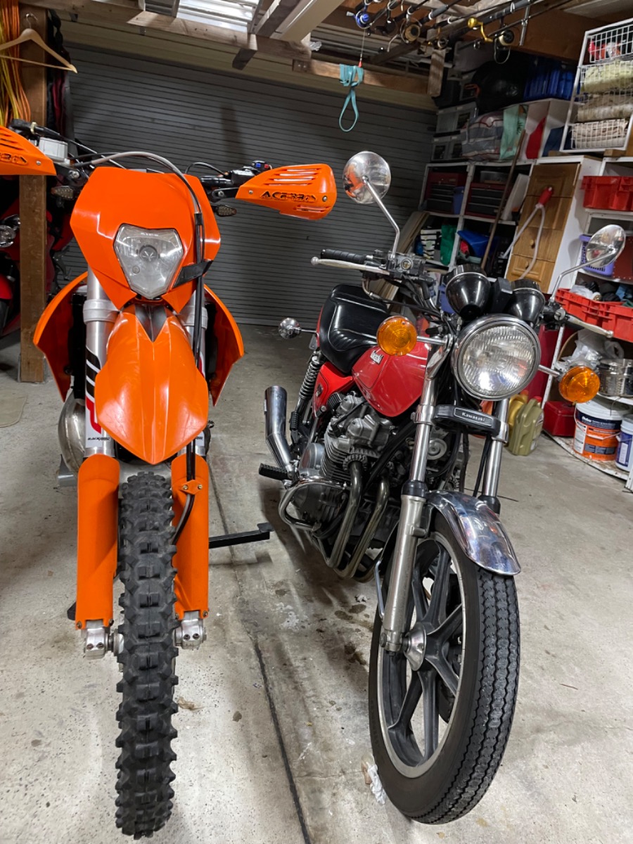

Hey guys I took the petcock out of my 1979 kz650 ltds gas tank and disassembled it, now once it’s back together and installed in the tank fuel leaks out of the prime line, regardless what position I have the petcock fuel flows out of the prime hose any help would be greatly appreciated
