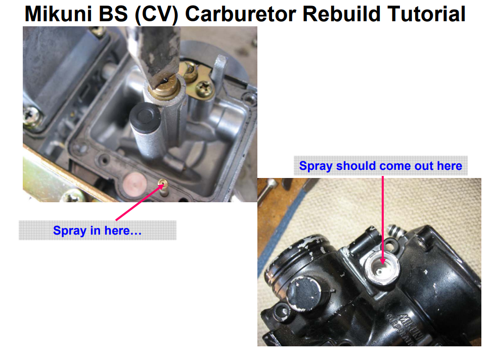

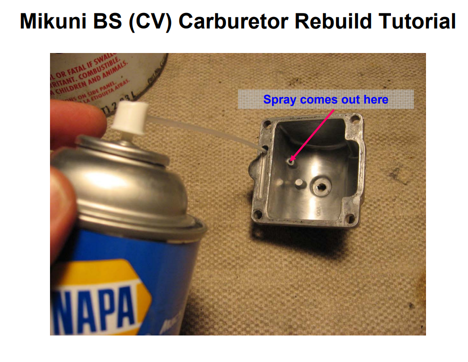

Did you perform these two steps? The first is actually backwards: put the spray nozzle down into the hole on the bottom of the cavity. That's easier to do that spraying into the choke pickup tube.
The reason for these checks is to make sure the carbs have clear choke passages.

Yeah @Nessism I did both of those things from your guide. It took quite a bit of cleaning to get the spray to come out of the passage in the float bowl but I got all 4 to flow. If I need to disassemble and check everything again I have no problem doing so. At this point, I am just eager to ride the bike so I will do whatever I can to do that.
