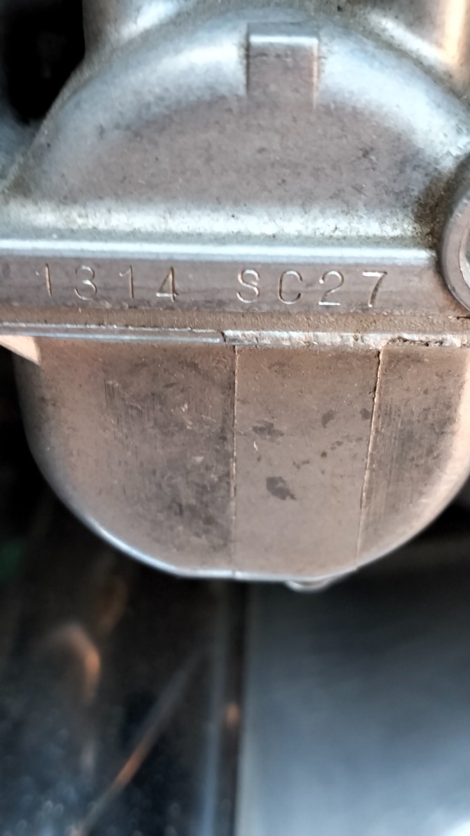

Hi, I'm asking for help. I have a 1977 KZ 1000, the previous owner replaced its original carburetors with Keihn code (1314 SC 27), I think the originals are VM 26 SS, can you confirm this? If you have a photo, thank you. With the current carburetors I can't align them with the carbtune vacuum gauge. There are three adjustment screws, I would like to understand what they regulate, from left to right: the first cylinder 1-4? Central all 1 2 3 4? The third last 3-4? Also, the third vacuum gauge rod oscillates a lot, what do I have to check? If anyone of you has the original carburetors for sale, tell me the price or some info where to buy them. I'm also asking for help if you tell me how to do what to replace for these that are already mounted, which jets, atomizers and more. Also, the throttle cable with a single wire was mounted on the bike, not two like the original. Help. Thanks

The stock carbs were Mikuni VM26's. Your bike seems to have Keihin CV34 carbs, which were installed on many KZ750's in the early 1980's.

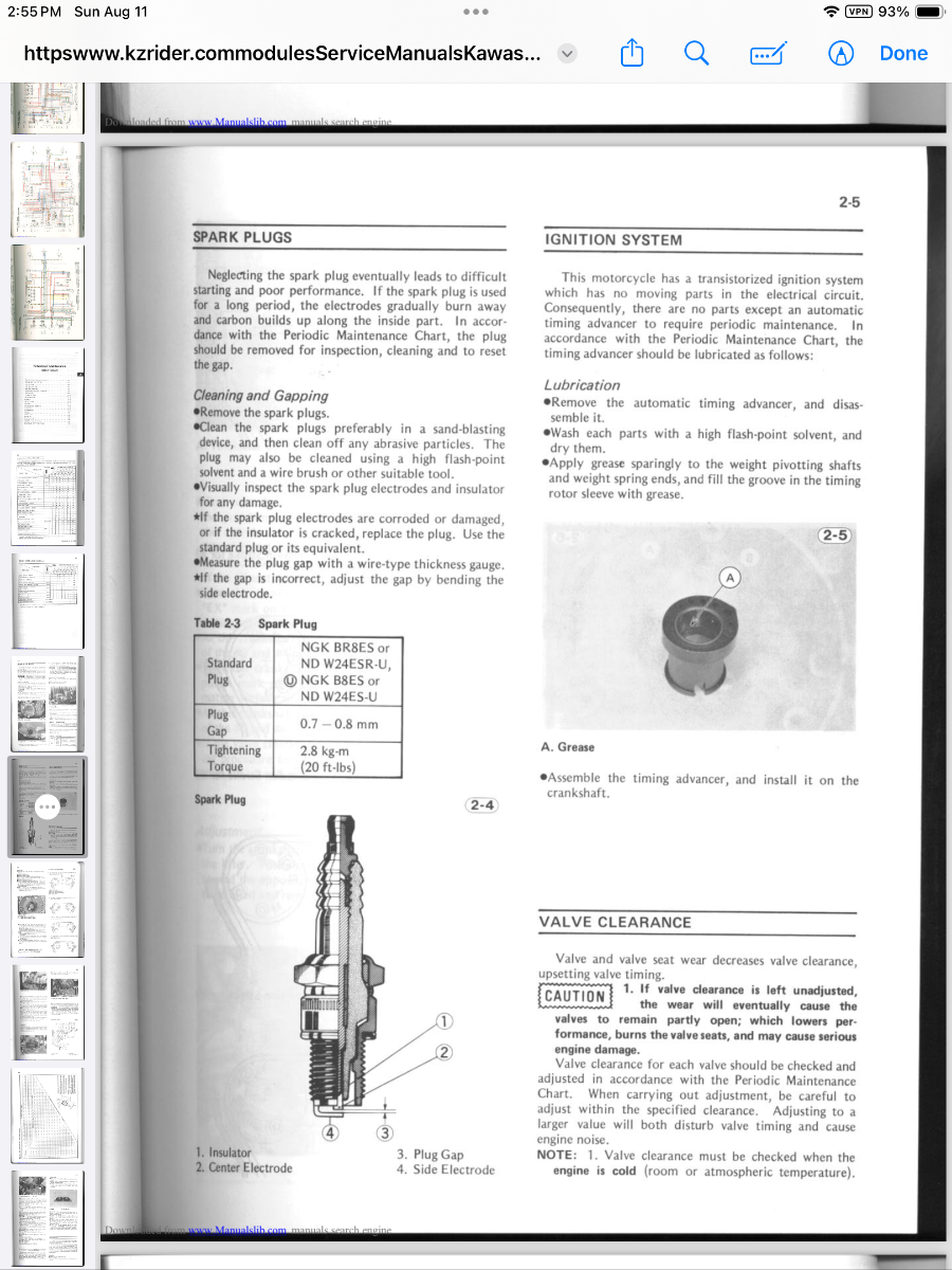

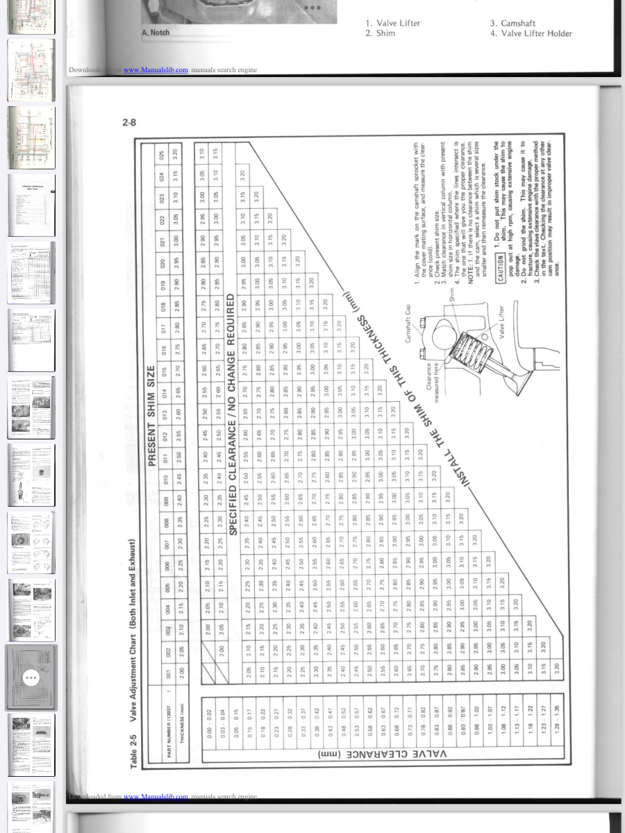

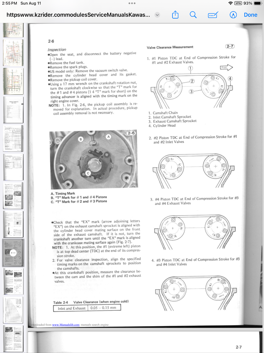

[justify]Thanks, now I understand. For valve adjustment, I generally do it on small bikes at the end of the compression phase, for this bike which notch should I see on the F T advance? with crankshaft rotation x 180 degrees? Is the sequence 1-4 2-3? Do you know of a post on the forum where I can translate and see photos. Thanks, you are very kind[/justify]
- Posts: 8176
- Thanks: 2667
Re: carburetors kz 1000 1977
11 Aug 2024 12:54

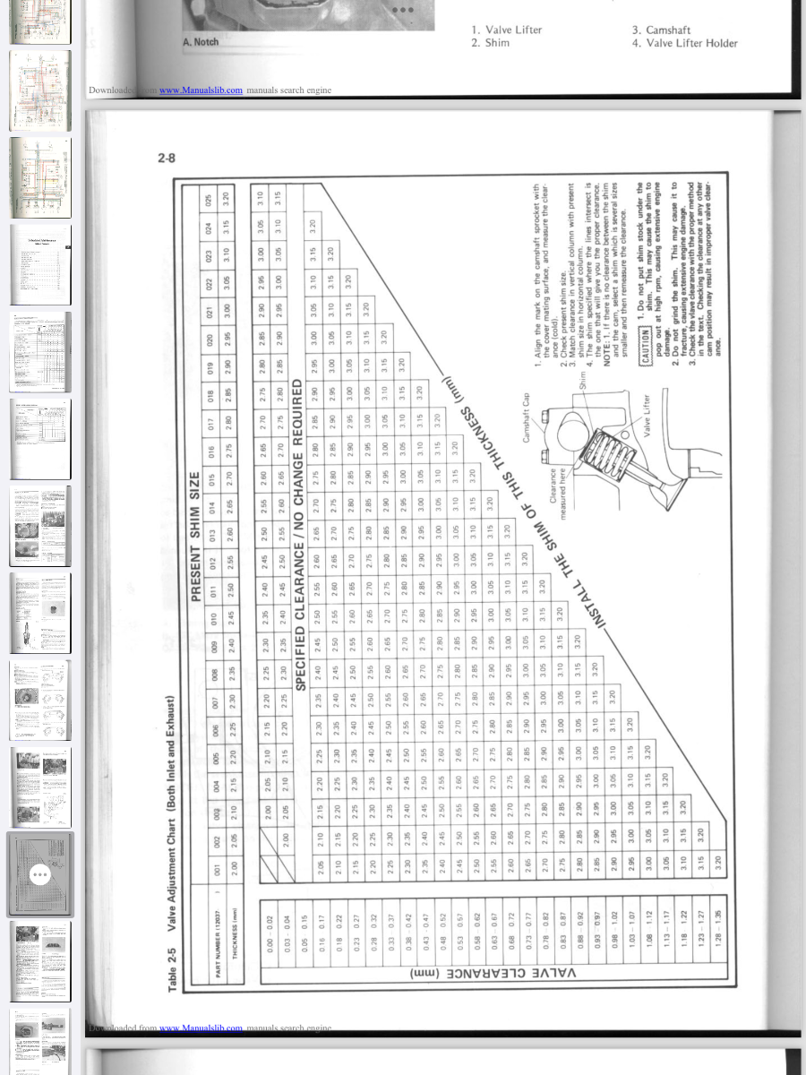

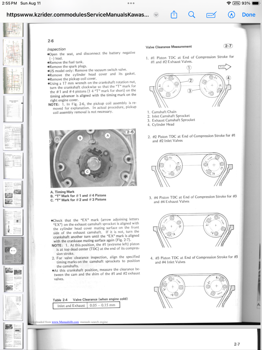

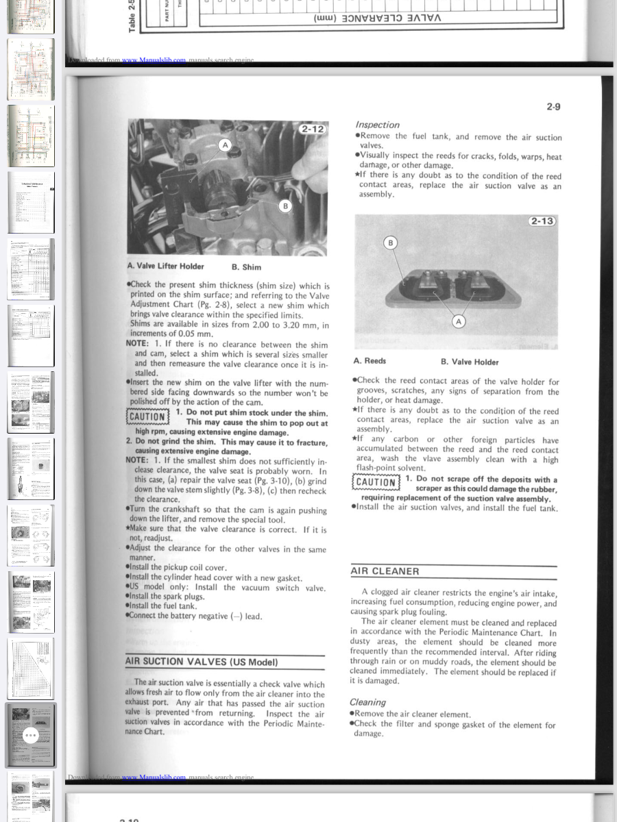

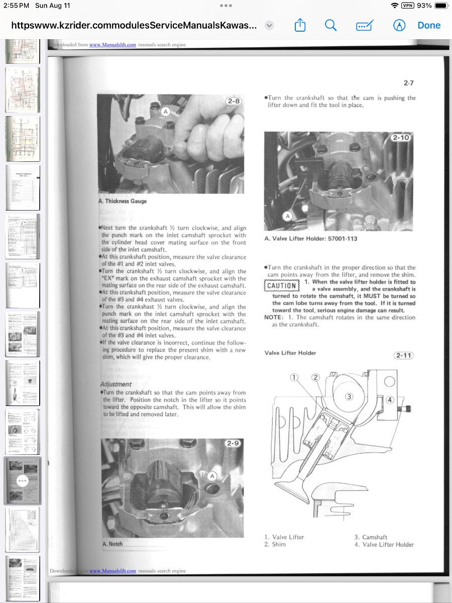

See pages 2-5 through 2-9 in the factory service manual.

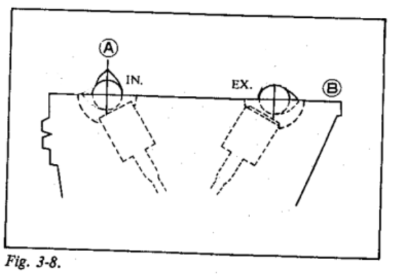

As long as you target the top end of the clearance range, say from .10 - .15mm, then you can simply aim the cam lobe away from the bucket and measure then.
This is a better method, that adjusts the valves in pairs.
First, remove the ignition cover. When rotating the engine, use a 17mm wrench, and only rotate clockwise.
The cylinders are numbered left to right, 1 to 4, as you are sitting on the bike, looking down at the engine.
Rotate the engine until the # 1 Exhaust lobe is pointing forward, parallel to the gasket surface (position B ), then adjust 1E and 2E.
Rotate the engine until the # 4 Exhaust lobe is pointing forward, parallel to the gasket surface (position B ), then adjust 4E and 3E.
Rotate the engine until the # 1 Intake lobe is 90 degrees to the gasket surface (position A), then adjust 1I and 2I.
Rotate the engine until the # 4 Intake lobe is 90 degrees to the gasket surface (position A), then adjust 4I and 3I.
