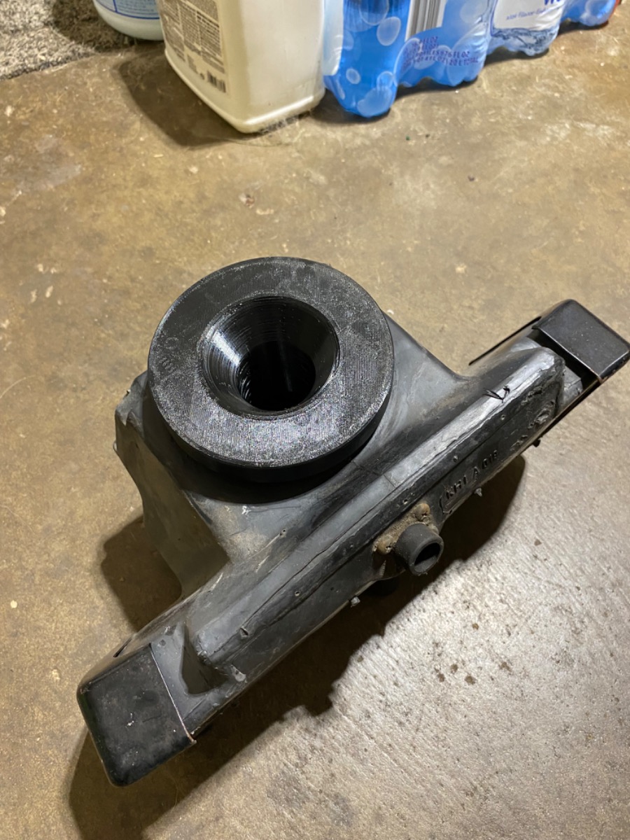

Hello all!
bit of a 3D printing nerd here.
I printed an air box cap for my kz700 and would like to share the results.

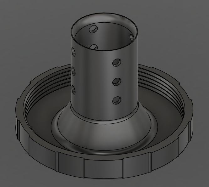

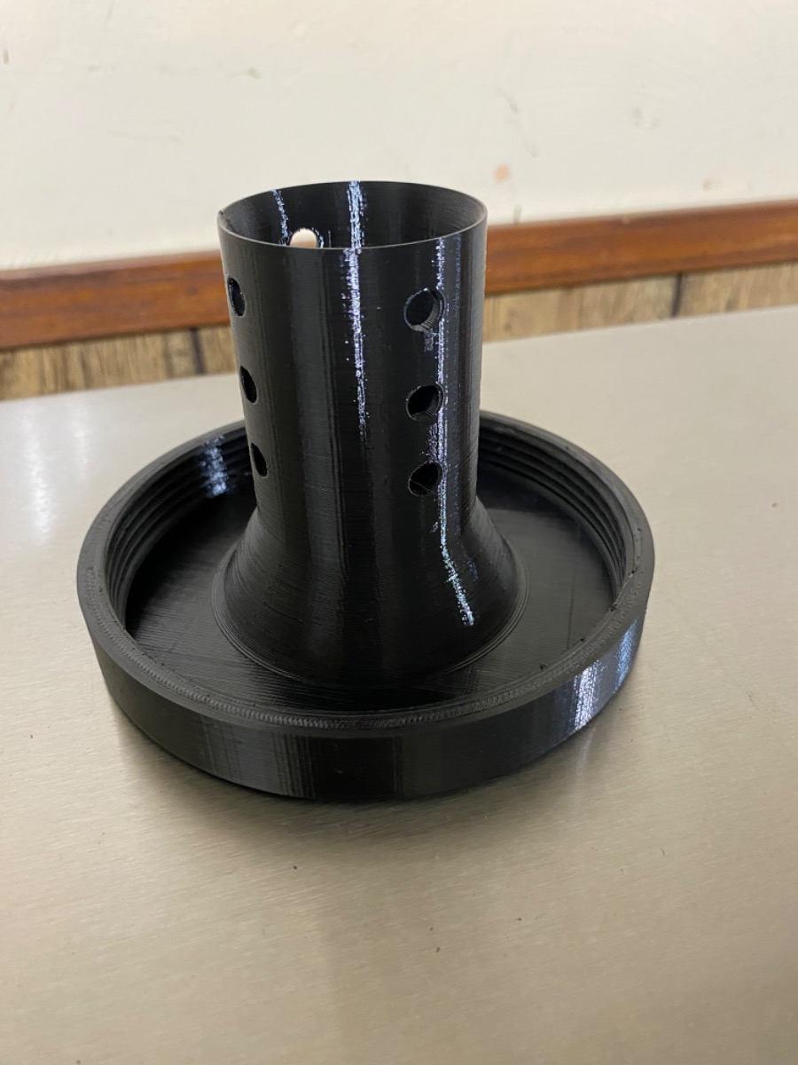

I used PETG. There's very minimal exposure to UV, so ABS wasn't needed.
Yes! I can provide the STL file for it, if there's interest. Or any of a bunch of formats. I modeled it in Fusion360.
Also an option, if someone does not have printing capabilities, I can print it for materials cost (approx $2?) + shipping.

expect at least one re-print due to scaling and 3d printers typically making circle ID's a tiny bit undersize.

If you need any changes made, let me know. I still have the model for it, that I used to create the STL.
I know the model is missing the "LOOSEN ->" label on the top, and the small notch where it's supposed to "click" when tight to the filter/airbox. My airbox doesnt have any mechanism to "click" as it's worn down, so I can't test/confirm that part.

Reviving post, as I've made some revisions to the file. It fits much better now, and i've added some scallops to the OD for grip.
File Attachment:
File Name: kz700 air ...p v4.zip
File Size:257 KB
Recommend printing "face down". Do NOT print from PLA.
