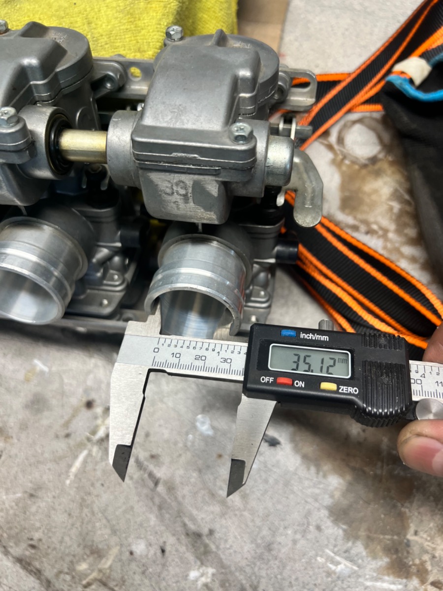

I just purchased these thinking they were 33mm because of the stamping on them, but when I measured them they came up saying 35mm...what do I have???

Measure the outlet (engine side) of the bore.

Does the bore taper inwards towards the slide (down to 33)

On the engine side, the aluminum piece is removable. These come in different lengths and diameters and some of them have an internal taper.
Remove the aluminum tube and measure the inside of the bore where it threads in.

Those spigots unscrew and you can swap them out for different ones, I've made some custom ones to adapt FCRs to a KZ750. Ideally the bore is tapering towards the engine, not the other way around.
