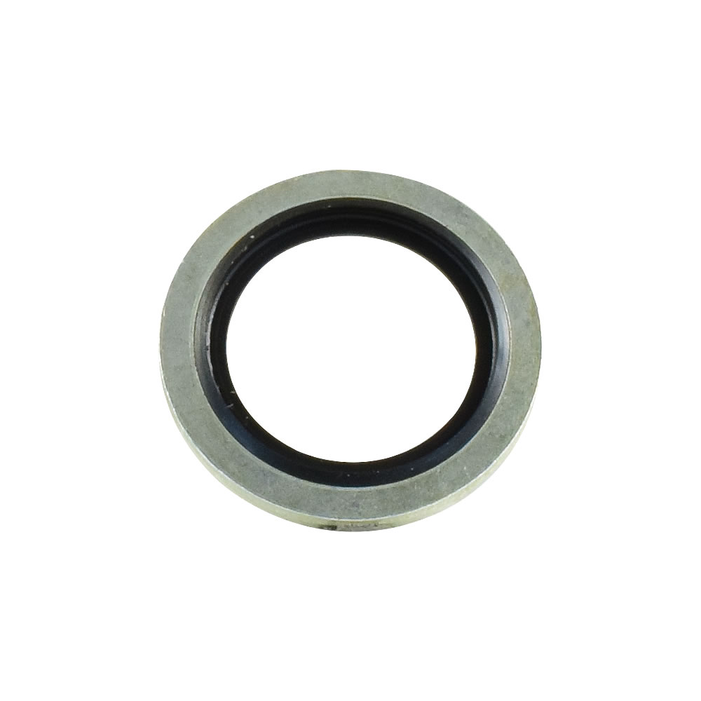

hi on working on another project would blue lock tight be ok to use as a thread sealer with ,its on the petrol tank out let i have o rings in place but i want a belt and brace ,i cant find any info on it if not what would be ok to use i have to use e 5 fuel but i do take the ethonal out of it thanks

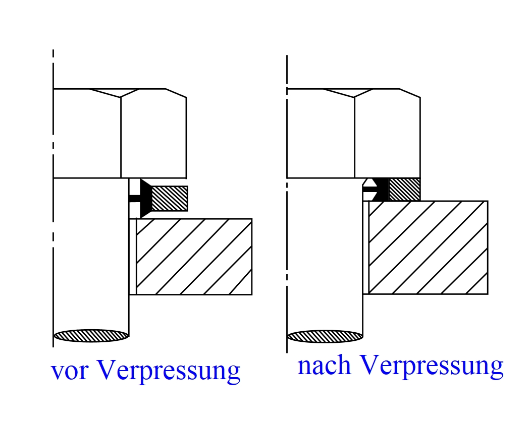

I would use USIT-RINGS
www.ttv-gmbh.de/en/seals/static-seals/usit-rings.php
www.hytec-hydraulik.de/normteile/dichtringeshop.html#05a
www.hytec-hydraulik.de/normteile/usit-ring-metrisch-m6.html
usit-ring-shop.de/Katalog/Usit-Ring-Sortimente/
